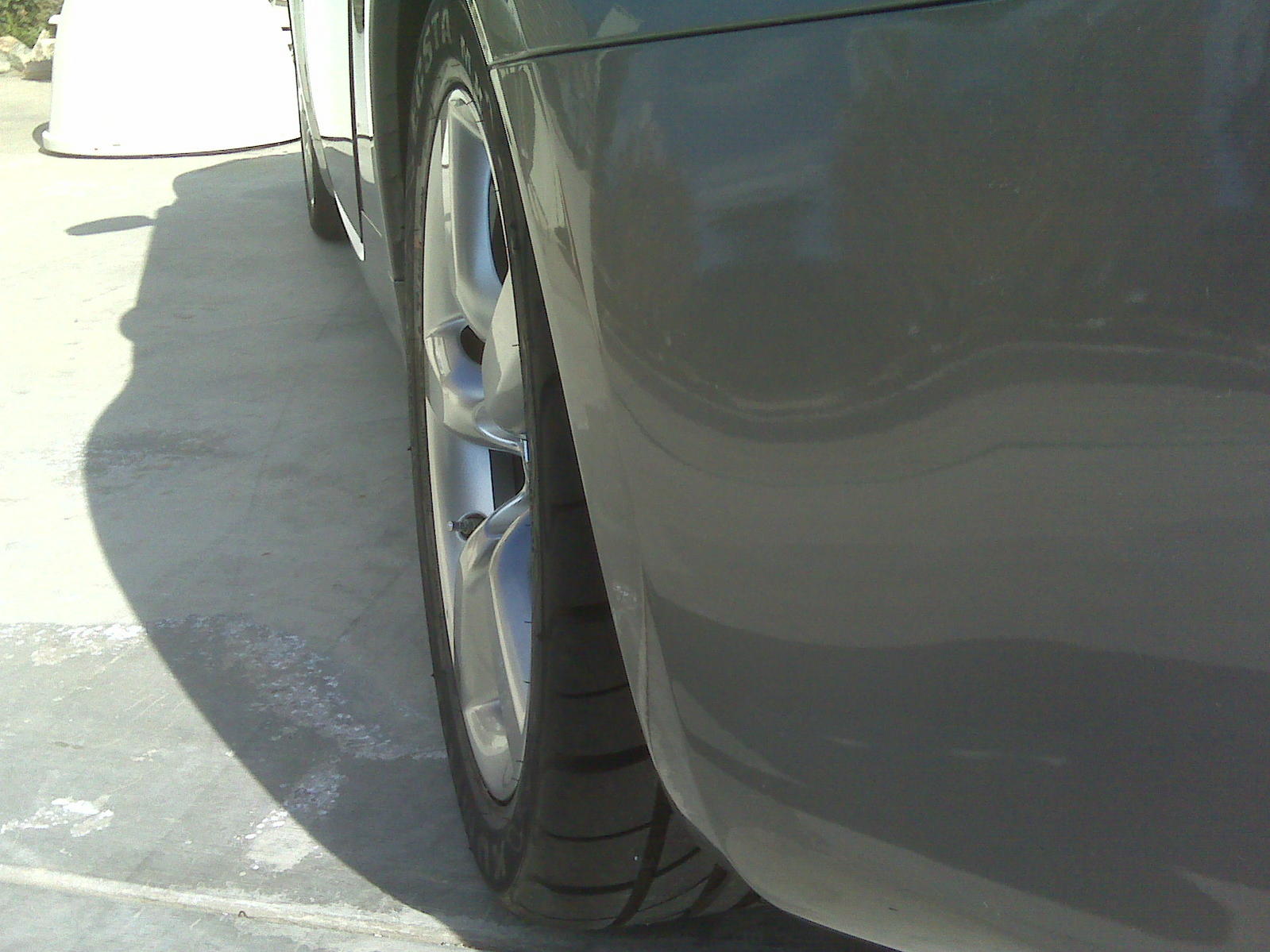

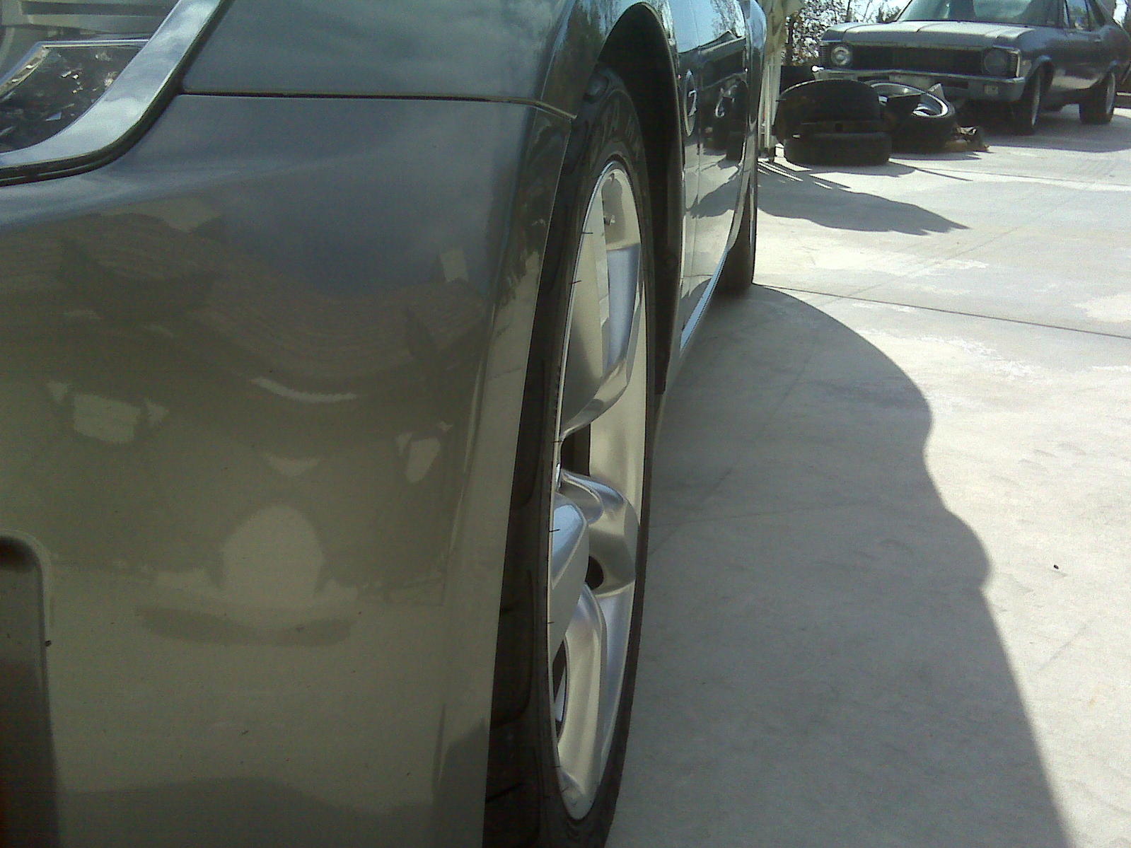

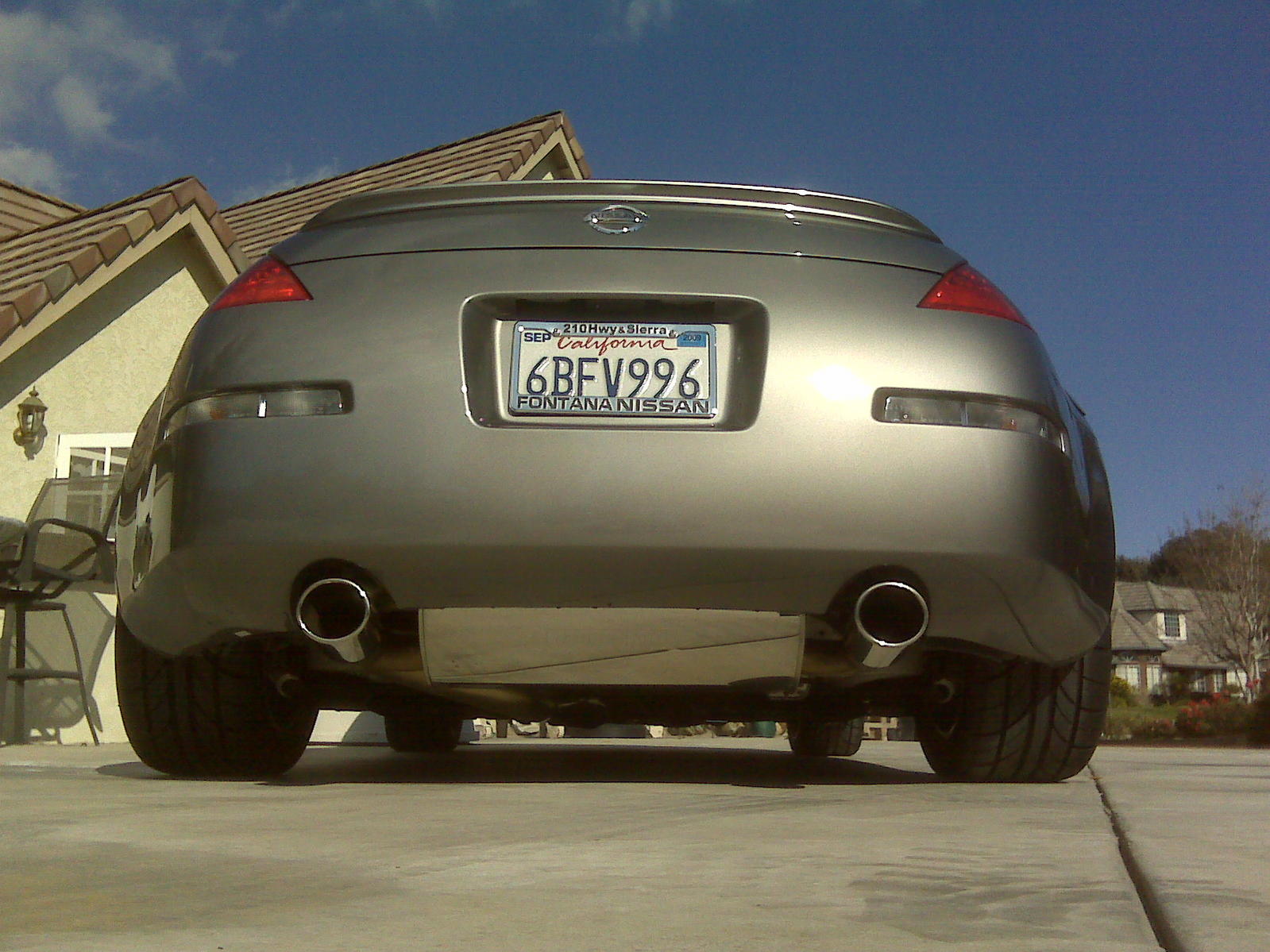

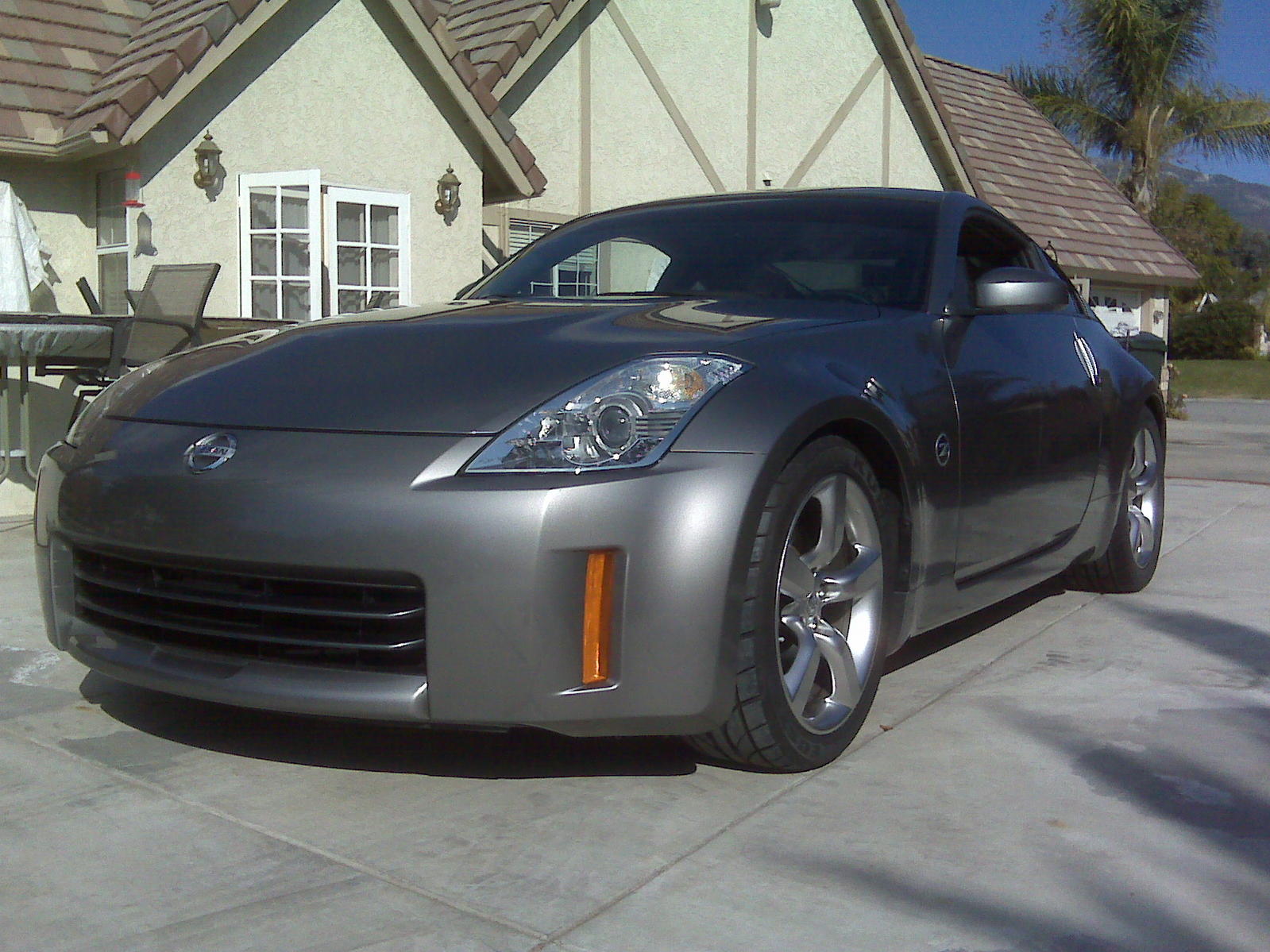

Here are some pictures of what 275/40-18 and 245/40-18 look like on factory 18's. There is hardly a bulge and no rubbing what so ever. The best part is that my speedo is now only .5mph off! It was 3mph off with factory tires..... Let me no what you guys think.

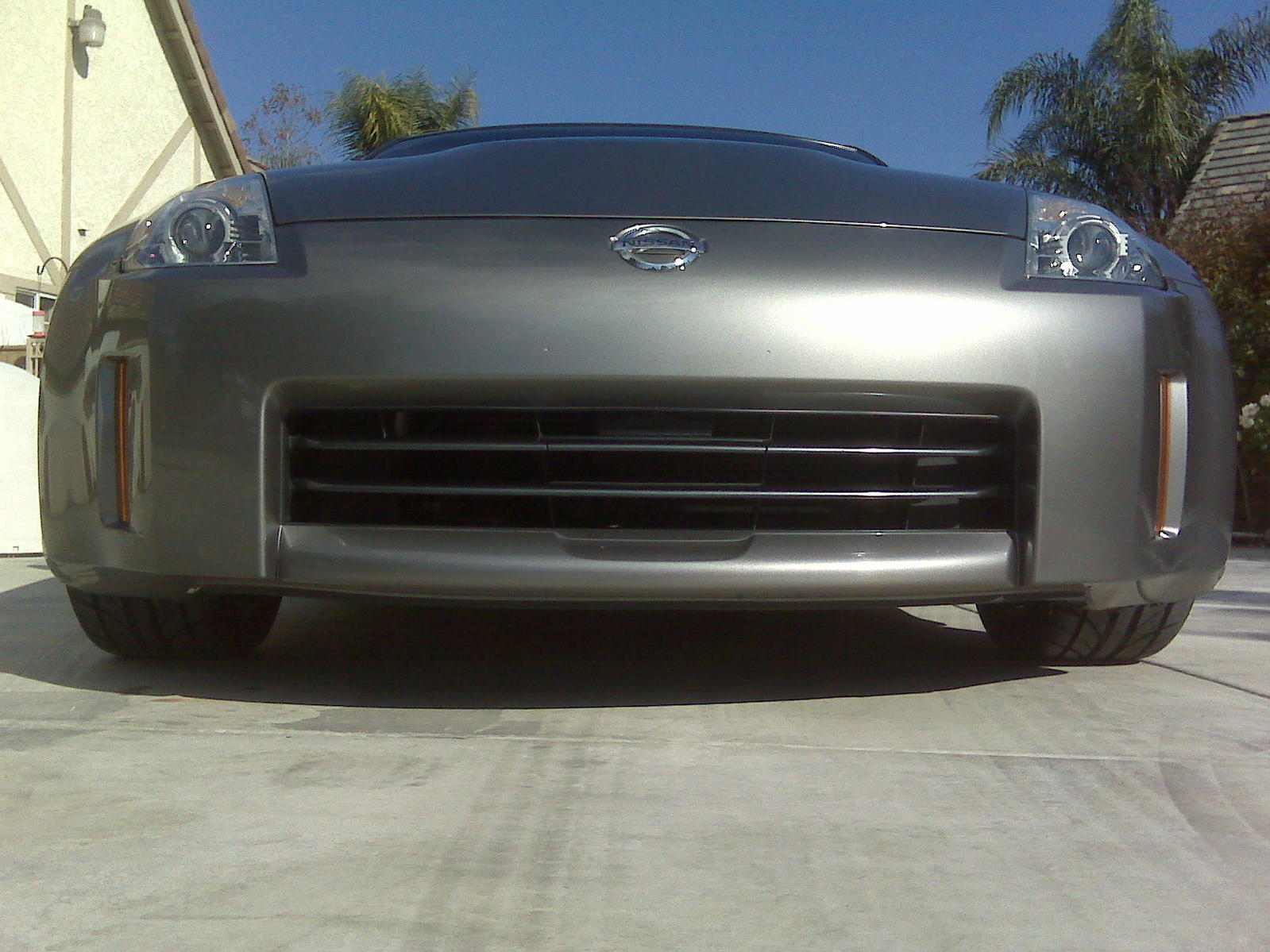

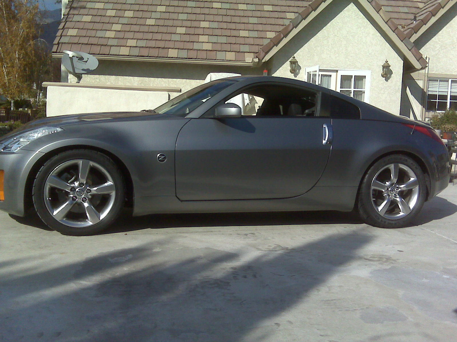

more pictures....

I like it!! Probably could have gone 255 on the front.

Thank you for the pics, these are what I have been looking for, for a long time. This confirms exactly what I thought. Tires that wide fit perfectly, and with little to no bulge!

Depends on the brand tire, my INVOs didn't fit a 9 inch wheel for chit, 9.5 is the min i would run those tires on.
