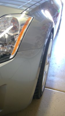

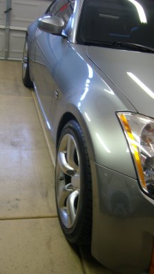

Another member's setup: 25mm All around
Before:
After:
Attached Thumbnails Wheel spacers for stock rims-p1020852.jpg   Wheel spacers for stock rims-p1020853.jpg   Wheel spacers for stock rims-p1020859.jpg   Wheel spacers for stock rims-before.jpg

Another member's 25 mm all around, Not lowered w/ stock wheels

u guys dont' feel like 25mm all around makes the fronts look more flush then the rear?
I feel like 5mm more in the rear makes it loook alot better, but just my opinion haha.

Last One fellas: 25mm all around on 4 corners w/ stock 18" wheel
If by now you can't see why 25mm on stock wheels is the best way to go
without any issues of rubbing or having to roll your fenders then i dont know
what else to tell you.
<img src="http://img255.imageshack.us/img255/6776/img1058je0.jpg" width="650" height="450" />
<img src="http://img255.imageshack.us/img255/7597/img1057ia7.jpg" width="650" height="450" />
<img src="http://img511.imageshack.us/img511/927/img1046bb0.jpg" width="575" height="450" />
<img src="http://img511.imageshack.us/img511/5914/img1048ob4.jpg" width="650" height="450" />
<img src="http://img170.imageshack.us/img170/1064/img1037zr7.jpg" width="425" height="450" />
<img src="http://img255.imageshack.us/img255/6845/img1053us7.jpg" width="650" height="450" />
<img src="http://img511.imageshack.us/img511/7209/img1052kd4.jpg" width="650" height="450" />
<img src="http://img170.imageshack.us/img170/7370/img1036xc7.jpg" width="425" height="450" />
+1, could you run 30 in the rear without rolling fenders or camber???
Yes, on stock height (even a mild drop) with OEM camber.
25mm F / 30mm R is the best setup for stock rims/tires.
