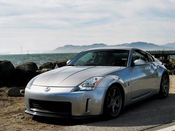

As Dave said, 19.9.5 with 19x10.5 +20-25 is common. Here is my old set of Volks that were 19x8.5 +22 and 19x9.5+22. 255/35 tires on the front with 275/35 tires on the rear, and as you can see, the car was lowered quite a bit on Tein coilovers. No tire stretch, pretty flush, and no rubbing. Sounds sort of like what you are looking for, so figured I'd post them up.
