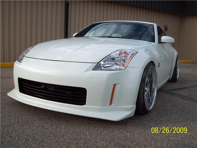

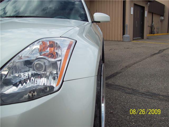

Nice find, to get the fronts to work your going to need to pull your front fenders about 10mm or so and run around -2.5 to -3 degrees camber and run a 235 tire ( I'm running 10.5 +4et front and this is what i did to make them fit, if your lower then me they wont stick out as far as mine do in the picture and you could probably run a big tire like a 245) the rears are more aggressive then mine.

if ur not educated in offsets then dont do it... a bunch of us are running the same width.. but that offset is whole diff ballgame. -10 is going to stick out very far..the guy u seen running a 11 width on here prolly has atleast a +20 offset.. ur going to need extended lugs, fender mod, suspension work. and to me it just wouldnt be worth it or very safe. i wouldnt do it.
