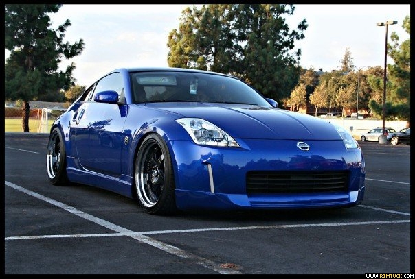

Im wanting to get 9.5 front +15 and in the rear 10.5 +11.Will this give me that flush look?? Can someone post a pic of this type of set up or close too. Im wanting this kind of setup.

That set up looks more aggressive than the offsets you posted. Go to the aggressive wheels and stretched tire thread and go through the pages most guys list the offsets they are running. Tire size also matters alot when running aggressive offsets. The sizes you posted will be fairly flush if you run 255F and 275 or 285R but if you want stretch and poke you might want to go more aggressive with the offsets

Sounds like the poke look to me with tiny tires. A 10.5 with a regular tire (295ish) needs an offset in the mid-20s+.

You picked good offsets. They might not poke quite as much as that Z you posted, but those are a good aggressive offset that you can fit without much hassle (no more than a rear roll needed).

the rears will look like this just 1mm in and the front would be 3mm in with your offsets.
this set up is a 19x9.5 11mm front and 19x11+18 rear
