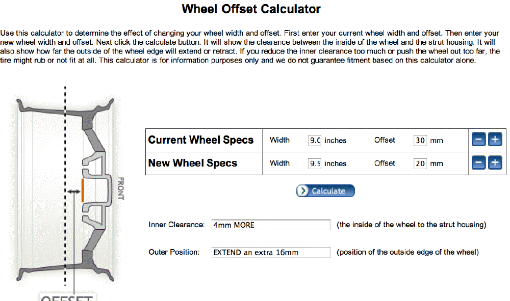

hi! first advert my english is bad... I buy Rota p45r in the measures 18x9,5 et20 all set, this measures is correct for clear front brembo brakes??? or touch in front brembo brakes with this offset?

^^^ what a tool , doesn't help the OP at all.
PM or email wheeldude for answers or look thru a thread with Rota wheels.

The Rota P45R in 18x9.5 +20 fitment will clear the OEM Brembo calipers without spacers This is the exact setup I recommend for the 350Z as it will fit great (accepts a wide variety of tire sizes all on stock fenders), look great, and offer nice performance
