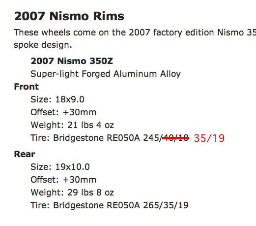

You are all over the universe on this. Make your life simple. Here you go.

These are stock photos. Do you think it is a good idea to get the wheels BEFORE shopping for tires?
lol honestly bro, im new to the wheel world, but i posted the info given because its what i wanted and what im looking for, those wheels specifically, to answer your above question, yes they are stock photos because i dont have em yet, i want to get tires before i get the wheels. basically i wanna know what aggressive, beefy tire setup i can run with these wheels, i dont care if i gotta roll the fenders or use a camber kit (not crazy camber though), i just wanna get a tire setup that will best fit these wheels, not the nismo wheels, if i wanted those, i wouldve posted asking about tire setups for those

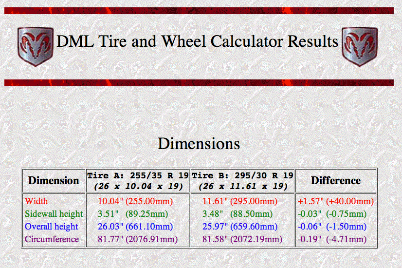

I ran the sizes on the tire calculator i found on the forums, with the tire setup i was asking about, the front (255/35r19) has a difference of .66% and the rear (295/30r19) has a difference of .43%, again im new to this, but if i correctly understood, you add the two percentages and if theyre less than 3% youre in the clear for your TCS/VDC right? so added they equal a 1.09% so i should be in the clear right? well if i did it correctly, however, if i change the rear to a 35 profile tire, or the front to a 30 profile tire, the difference goes up by over 3% just for that side, so i thought i found the perfect setup, but i wanted to ask since im new to the wheel world like i stated before, lmk if im correct about this. Also, will you be able to see the difference too much if you run a smaller profile tire in the rear?
I should be more clear. I do not want you to get the NISMO wheels. I am only using these wheels-tires as an example. The tire sizes above will be good for your wheels.
Thanks for all the help guys
Front tires are taller than rear.
