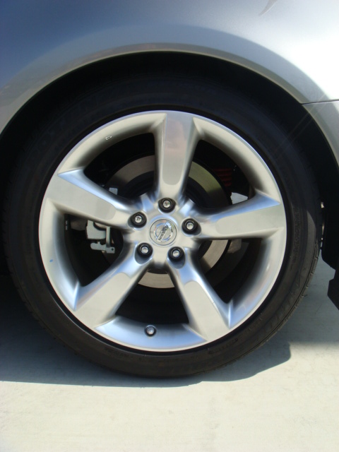

ok i have a question...
first off i have a 2006 350z
and i have just purchased some after market rims
i am taking the old tire pressure sensors out of the old rims..
and installing them into the new rims with brackets.
my question is i want to keep the old stalk rims for winter.. but after i take out the sensors.. i loose the air stem. everything..
can i install regular valve air stem in the rims? without sensors..?
if i can what type of stem? will any work?

Your local wheel shop can actually put basic valve stems back in your stock wheels after you take out the tpms. Just do it at the same time. When you put back on the stocks for winter, you will get a tire pressure low light though. It's no biggie, just a heads up.
Yes.
thanks allot .. that was exact the info i was looking for.. =)
