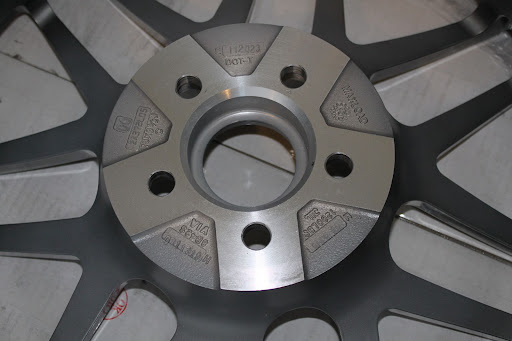

Higher offset F14 very little material left.
Lower offset wheels. More material more weight.
Originally Posted by jblz
I should be recieving them in a week. Weight was a primary concern of this purchase.
http://www.forgestar.com/blog/?p=374
The lower offset F14s will have more material in the back hub section/back pad, thus more weight. They adjust the offsets by shaving (milling) off material.

^ The good news is that while the weight is higher, the wheel inertia is not terribly higher since the added weight is near the axis of rotation. The torque required to accelerate the wheel to a given speed within a given amount of time is directly proportional to the wheel Inertia. If you added the extra weight out at the 9.5" radius of the wheel, then the effect may be more noticeable, but given that the weight is added at ~2.25" radius I doubt the butt dyno would notice a difference in acceleration.
Of course, the unsprung weight is increased regardless, so there is the handling aspect to consider.
