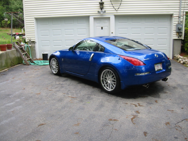

I have to get new tires can I go with 295/30/19 on my 19x10 on the rear and it's lowered with the eibach springs. Not sure with what tires to go with what do you guys recommend.

295 will fit the 10" wheels but IMO, it looks too wide for that size wheel. I have them on my 10.5 and don't think it'll look nice on a 10".
There are only 2 brands you can go with in that size, Continental and Pirelli. Pirelli is a little wider than the Conti.
BTW, what offset are you running? You might have to roll the fender if you're running a low offset.

I'm not sure what offset I have but I know it's alot different then yours, I have the same wheels but not that rear lip WOW. I went to a car show in Boston tonight and town fair tire was there and thats you I bought the tires from originally. I talked to the guy and he said to go with 245/35/19 front and 285/30/19 in the rear. I thought everybody here says to go with 285/35/19, that what I would like to go with cause I dont want the really want to have some kind of sidewall because mass has bad roads. I'm up in the air don't know what size to go with in the rear. I don't want to have to roll the fenders and everything start rubbing. Also I need some rear toe arms whos good and where is the best place to get them. Thanks
