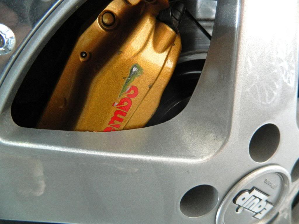

Whatever, I took what I could get. Before I packed the wheels I mounted them to ensure brake clearance...here comes more disappointment; fronts do not clear Brembos. I emailed him the info/pictures and he replies that I was sent the highest disc Work makes blah, blah, blah. So I figure I have at least 2 weeks to wait before I see these wheels again and order 3mm spacers.
Ok, so 2 weeks go by and I get my front wheels back. I mount them (wheels in the air) with the 3mm spacers and they don't touch the caliper but it's close. I drive 20 feet down the road and hear this rotating thumping coming from the front; I know exactly what it is.

At this point, the whole transaction is getting aggravating. I email him again with pictures stating I was told these wheels would clear Brembos and I didn't want to use spacers; hence me ordering custom wheels. He replies with pictures of him putting high-disc Equip faces on his R33 w/ Brembos; which means nothing to me. He even told me I could Google "Work Equip disc type," so I did him one better and emailed Work themselves. I received a reply from Logan at Work USA (admin for iputinwork.com) and here was his reply:
"You are correct, the Equip 5 spoke in 18" (since you have a 19" step rim) in R-Disk does not clear OEM Brembo on a 350Z.
The disks between wheel models are completely different, so "R-Disk" in one wheel is not the same clearance as "R-Disk" in another. In the case of the VS-XX, yes, the 350Z Brembo in 19" would require a R-Disk + 7mm spacer front. The Equip and VS-XX were both designed in the late 90's / early 00's, so it is understandable that at the time no one could predict the oversized factory calipers of today."

I definitely don't think he should be claiming certain wheels clear Brembos when they don't. It's not like you can buy OEM Brembo touch up paint.

You almost can. Humbrol #54 is a very close match. There are a few threads here about using it to touch-up OEM Brembos. Worked great on mine.

Damn, that really sucks especially the mark on the caliper. Here's hoping he compensates you for your troubles or at least makes them right. Most places don't really care for customer service anymore though, unfortunately. :/

I sent the last email to him before writing this review. I touched up my caliper and moved on. I still have trouble believing that I'm the ONLY person to purchase R-disc Equips from them with Z33 Brembos to have this issue and what bothers me more is I sent him multiple pictures without a spacer (could not install the wheel because it hit the caliper) and with a 3mm spacer (damaged my calipers) and he is probably still selling these wheels to Brembo owners stating they will clear.
