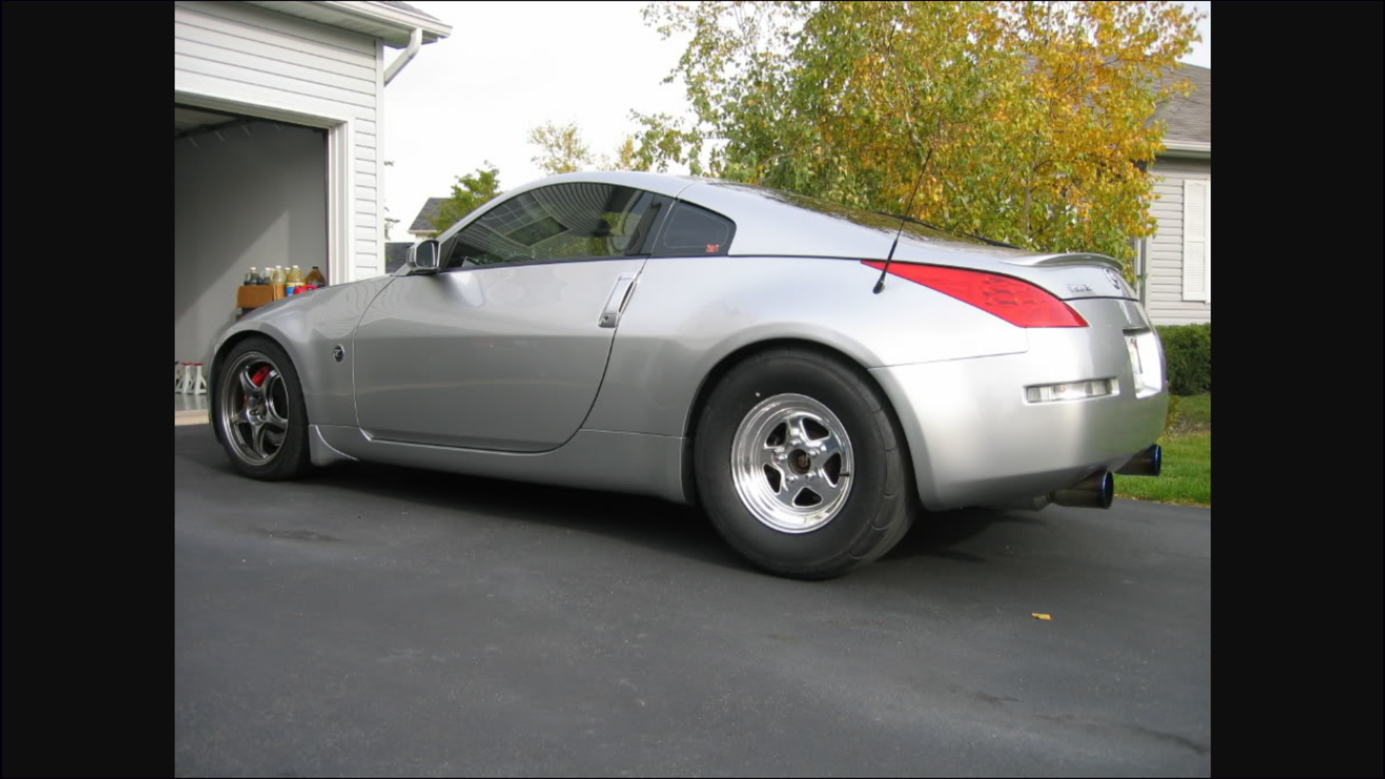

Hey all I'm looking to do some drag wheels and tires on my 03 Z33. I came across this picture and wanted to know if anyone could tell me what size this wheel and tire setup is? Looking for wheel size, offset, and width specs so I can recreate this setup. Also if anyone can rattle off a tire size as well that would be great! I'm looking to compete in the no prep and roll racing events at a local track next year so I want to be ready. Thanx in advance for advice and tips!

Originally Posted by OldManZ350
Rear MT 28 x 10.5 x15 (3055S)
Front MT 27.5 x 4.5 x 15 (3009)
On weld Prostar wheels
Im not sure if thats his car or not but thats his tire set up...

Awesome man thank you!! Just need some specs on the wheels offset and width so I can pick up a set.

I found the wheel size in the rear for anyone else who wants to know... 15x8 with 5.5 inch of backspace and 5x4.5 or 5x114.3 bolt pattern.
