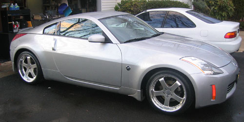

I just got the Axis Milanos and was also advised to do
275-35-19's in the rear and 245-30-19's in the front...
I've also seen them advertised the same way.
I didn't see a visual difference so I just went with it.
