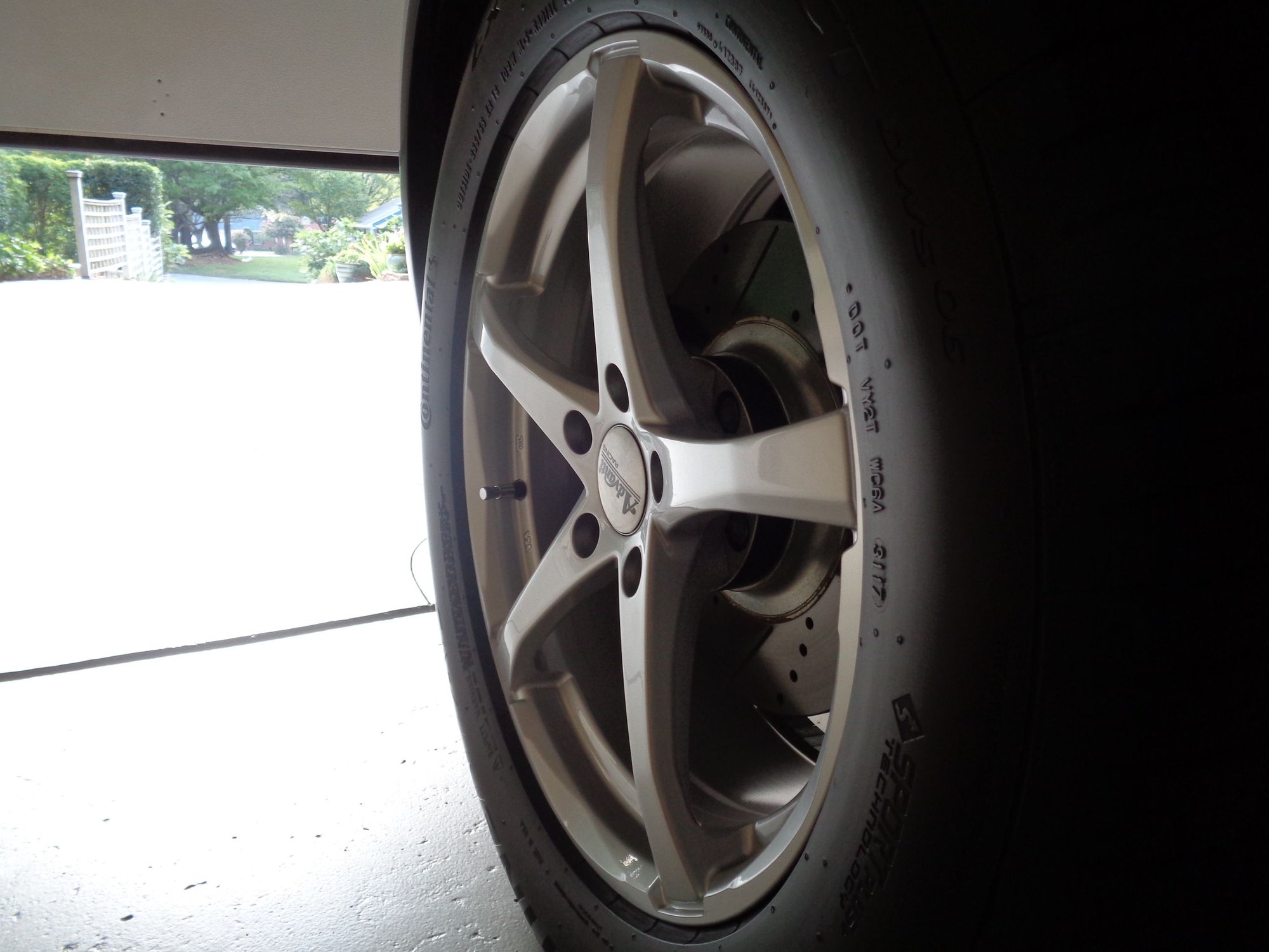

I prefer to be spacer-free as well but I'd rather use spacers than be confined to certain wheels just because of the offset. The spacers do add an interesting dimension to open faced wheels like mine though.
The bolts stripping are my biggest concern. I've got closed end lug nutz which prevents water intrusion and the car doesn't see salt. I was thinking about using a small amount of grease or anti-seize on the bolts and I always use a torque wrench to prevent over tightening.
