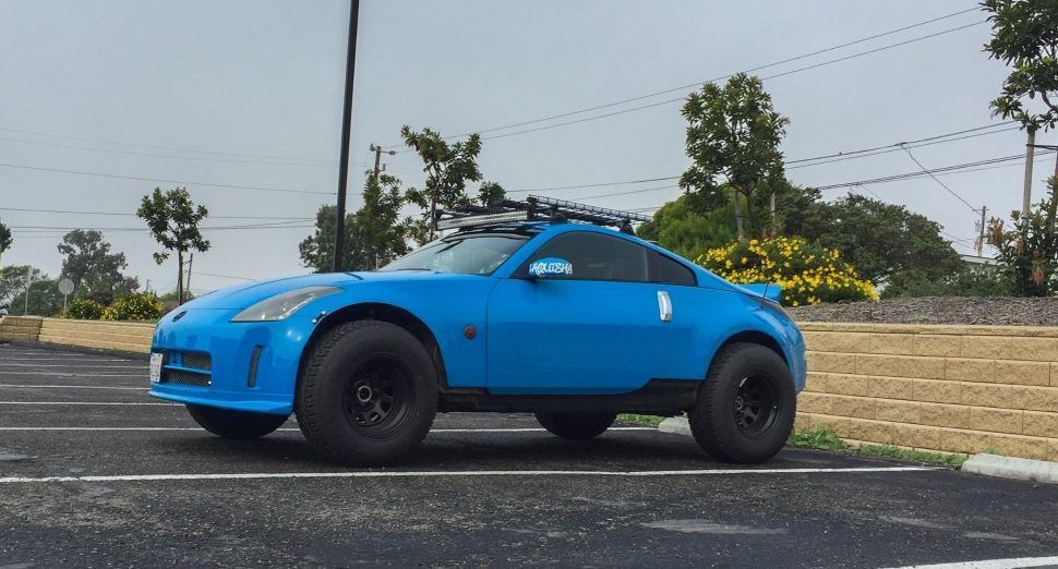

Originally Posted by MicVelo
I would drive the hell out of that.
Actually, as I looked at that, I was like "Pre-runner Z car! Hell yeah I could totally drive that! Haul my MTBs up the hill and into the wilds!"

[QUOTE=MicVelo;11058863]
Looks like a dune buggy.
