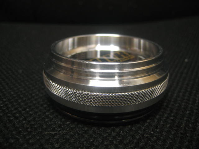

Are these the ones you want?
They are in stock now
Raised Volk Center Caps
Old Mar 12, 2004 | 05:34 PM
Jason@Performance's Avatar
Jason@Performance
Performance Nissan
Joined: Oct 2003
Posts: 8,783
From: So-Cal - Ready to go?
well theydont fit on LMGT4's...
atleast the size I have in stock... Guess they arent the same sized center caps...
but these work with TE37's etc...
