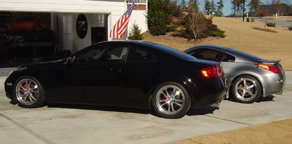

I would go 255/40 rear and 245/50 front. I run that on my wife's g35c, and it looks great, but you also have to lower the car, or it looks like its a 4x4. When lowered with eibachs, the wheel wells are filled nicely compared to the standard 245-275/35-19 combo.
Not sure of your offsets though. I'm running 8.5 +38 and have a 1" (26mm) spacer in the rear.
Attached Thumbnails 40/19 or even 45/19?-z-and-g.jpg

with our 255/40-19s, the speedo is off by only 3%. When it reads 60, I'm actually going 61.8mph. Which also means, when the odometer reads 60000, there will be actually 61800 miles on the car.
As an added benefit, we have a 39 month/39000 mile lease, we will actually be able to go to 40170 miles without indicating more than the allowed 39000, or and extra 1170 miles!
