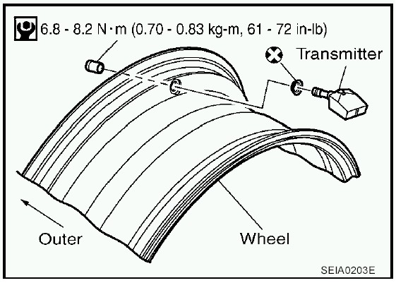

The simple answer to your question is: "The configuration of the rim where the tire pressure valve installs."
If your rim can accomodate the Nissan TPS installed so that the module lays nearly flat against the rim, then you are good to go without going to the trouble of a band-aid strap or other makeshift TPS mounting scheme.

Do you think these would work with the TPS in the hole instead of a strap?
No - valve stem hole is oriented in incompatible angle.

Originally posted by silverstoneTT
How about these? Do you guys think the valves will be able to screw in?
No - valve stem angle is incompatible with Nissan TPS angle. TPS does not screw to wheel. TPS stem inserts into valve stem hole with rubber grommet to seal. Nut is then screwed to valve stem to secure.
