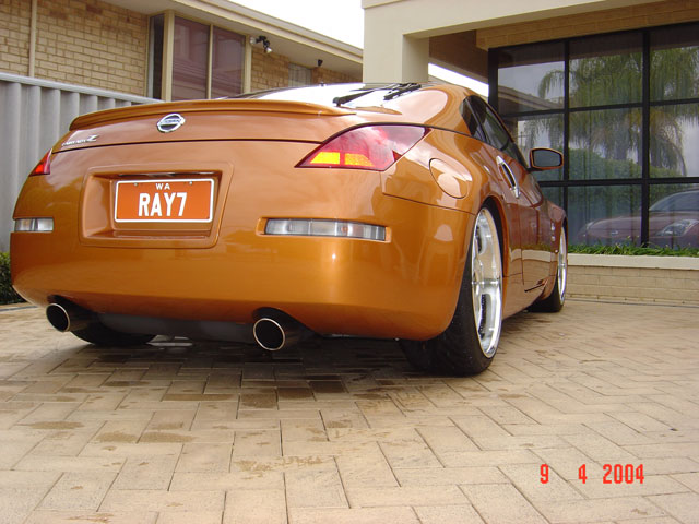

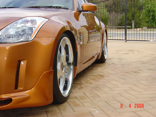

I have attached 2 pics showing the front & rear of my car.
From the pics you provided, I would really like mine to be the 10.5"/19's with 22 offset, definitely one with very aggresive stance and wheels sticking right out there...

Pic 1
Attached Thumbnails Please help me calculate the correct spacer size-dsc00144.jpg

Pic 2
Attached Thumbnails Please help me calculate the correct spacer size-dsc00146.jpg

I didn't know you were lowered. I don't think I would add a 1/2" spacer to that setup. I think you would hit the fender going over bumps. Seriously, you want it pushed out more than that???
If I were you I would measure the gap between the outer fender and your tire. That would give you the best indication of how big of a spacer you can go with. I would be suprised if it was more than a 1/4" or 6-7mm.

Umm...yeah...
The setup that I'm thinking about is to push it as far out so the tires is really close to the fenders, and since the rear well has some camber, I like the rims (silver) part to be inline with the fender...
I would appreciate if you could estimate the right spacer size for that setup...
