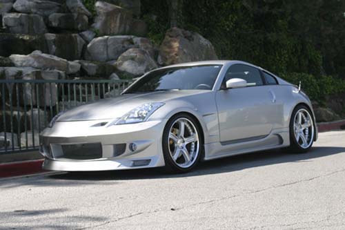

today i received my INGS+1 half kit and just ordered 20" axis se7en mods about 30 minutes ago.......20 by 8.5 in the front and 20 by 10 in the rear.......
was thinking of putting either S03 pole positions or MICHELIN piolot sports 245/35/20 for the front and 285/30/20 for the rear.......is this correct????
in addition to this what is the correct offset for this wheels(anyone with 20's please post both offsets and pics)???
i know axis knows what works for this car but i was wondering what the common consenus is....being I have VDC and it rains ever so often in NYC
any help is EXTREMELY and i mean EXTREMELY APPRECIATED....
BTW sorry for the crappy pic but thats the best my camera phone can do......

i have 20x9 in the front and 20x10.5 in the rears w/ a 255/35.20 and a 285/30/20
