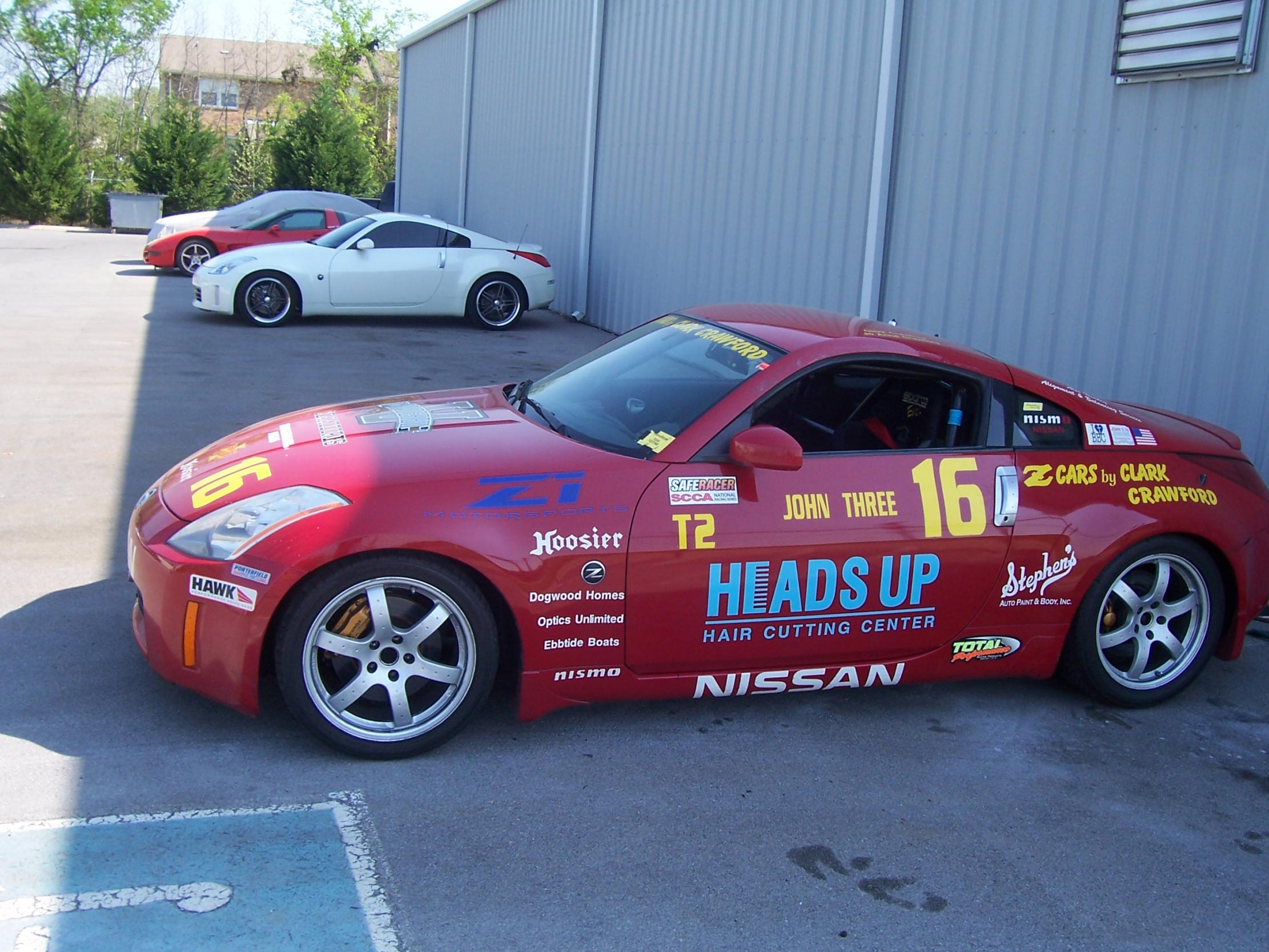

This is the second car we took to "The Performance Garage" in Smryna Tn. on the same day. The car belongs to my friend and mechanic of 23 years, Clark Crawford. He owns "Z Cars by Clark Crawford" in Nashville Tn. He is also an authorized Motordyne dealer. We did 4th and 5th gear pulls just like with my car.
INFORMATION ON CAR AND PARTS INSTALLED
2003 350Z T-2 SCCA National race car.

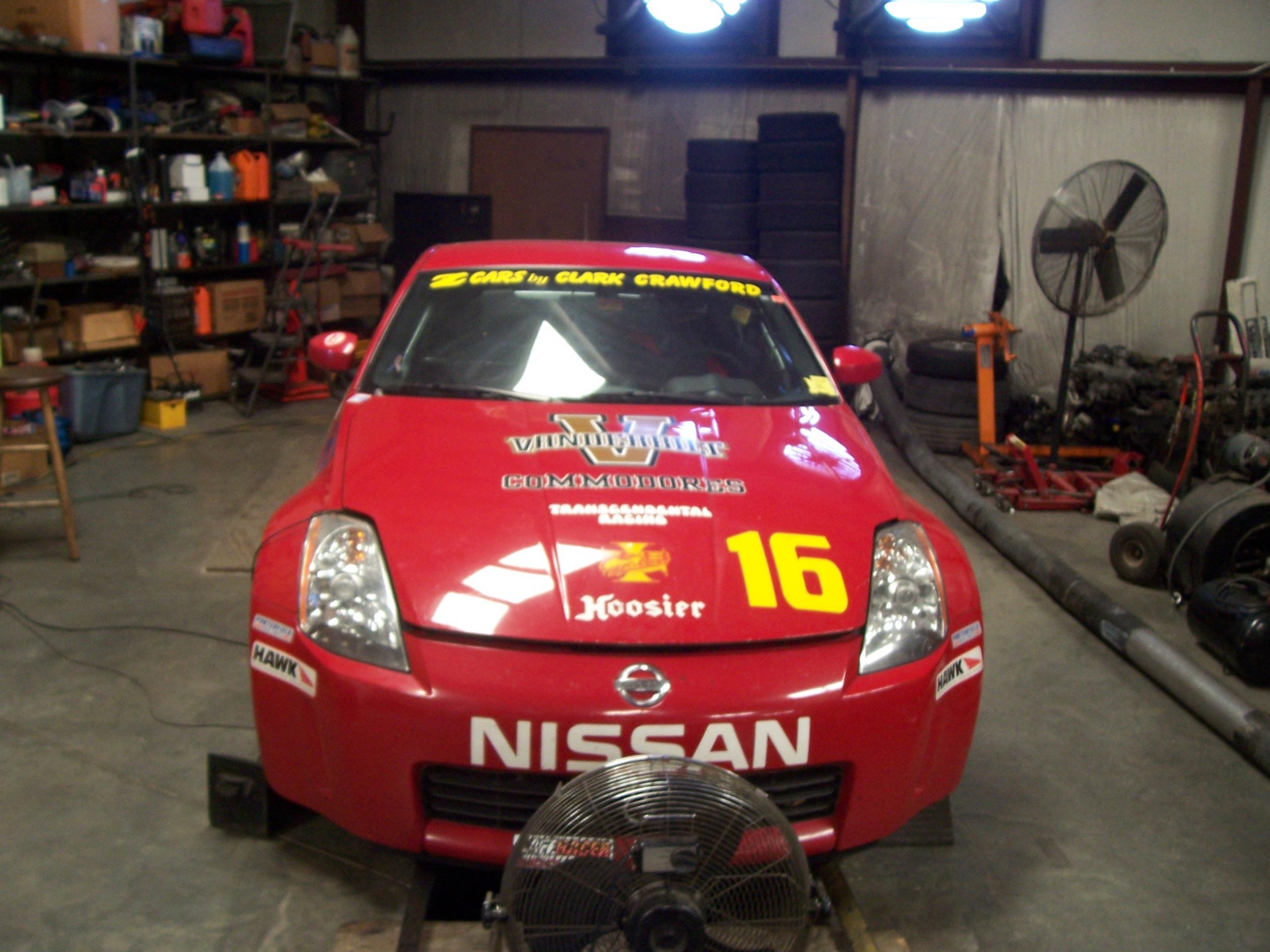

All dyno runs were done without unstrapping the car. We tried different combinations with A.R.T. Pipes, Z1 Motorsport pipes, 03 stock plenum and 06 Rev up plenum.

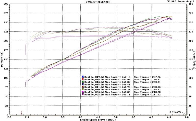

The dyno charts are a little crowded, but next time we will have it more separated. This was our first dyno experience.
____________________________________________________________ ___
Here is a list of the dyno run files with the different combinations.
4th Gear Runfiles.....
runfile 18,19 are Z1 pipes, 03 stock plenum
runfile 14,15 are ART pipes, 03 stock plenum
runfile 10,11 are ART pipes, rev up plenum
runfile 4,5 are Z1 pipes, rev up plenum

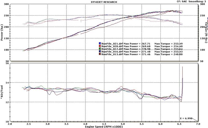

5th Gear Runfiles.....
runfile 20,21 are Z1 pipes, 03 stock plenum
runfile 16,17 are ART pipes, 03 stock plenum
runfile 12,13 are ART pipes, rev up plenum
runfile 6,7 are Z1 pipes, rev up plenum
Closing Comments.......
The biggest gain was the 03 stock plenum over the rev up plenum. You have to look at the graphs closely to see the gains with the ART pipes. "Without re-tune" Sorry again for the crowded runfiles. (We will know better next time)
We did a few runs in 3rd gear, but did not save them. On the next dyno visit with Chris we will do 3rd, 4th, and 5th gear runs with both cars. The race car uses 3rd and 4th gear most of the time on the track. RPM range 4500-6800
Final results... ART Pipes with stock 03 plenum and pulstar plugs (mrev2 and spacer not legal if you were wondering) 271HP and 253TQ which is a gain from Z1 pipes and rev up plenum 258HP and 236TQ. The rev up plenum is a pig !
The air fuel ratio is more consistant with the ART pipes and 03 plenum. Please note...without a re-tune.

You can definitely see the massive increase in power throughout the band with ART Pipes over test pipes.
Where? I see a marginal increase I think. Graphs are not easy to read.
