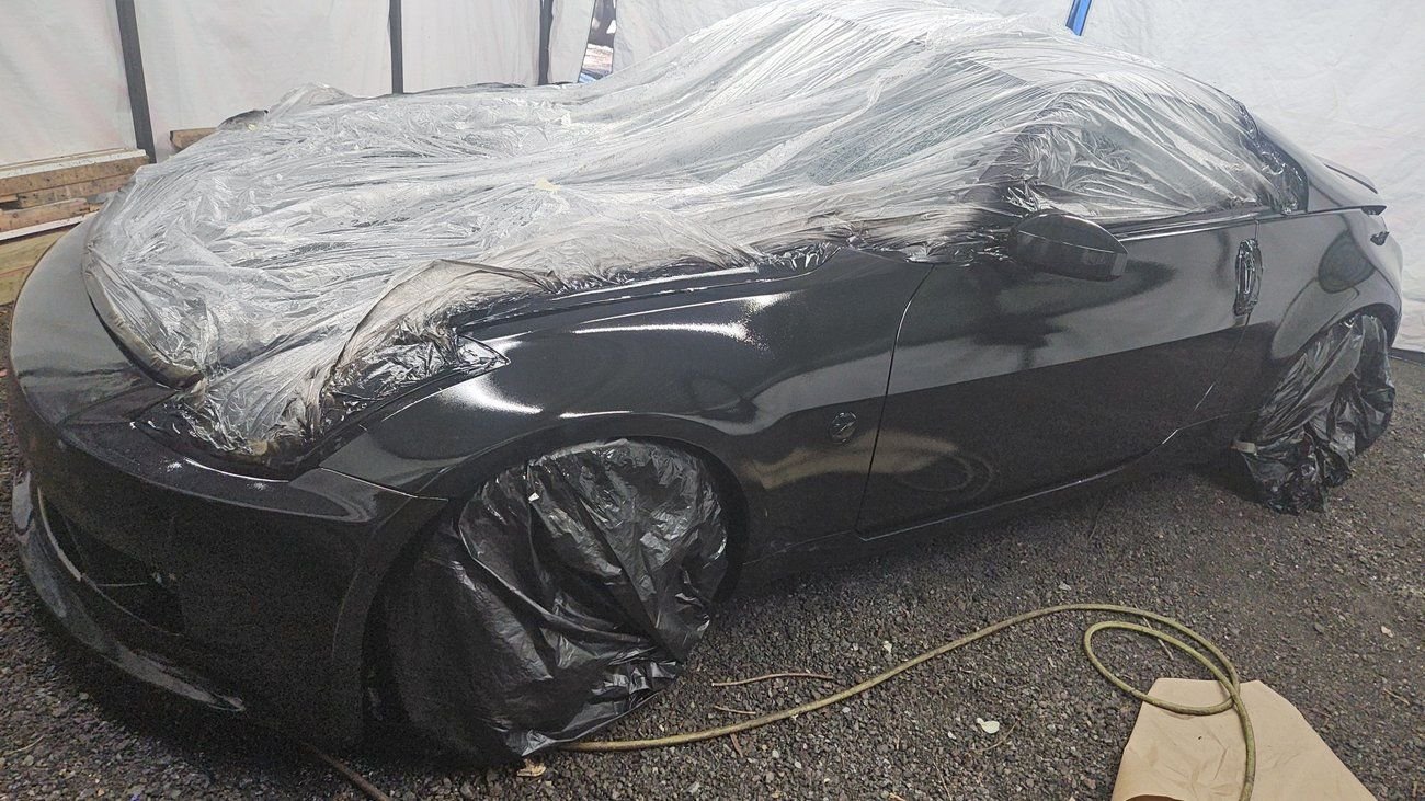

Hi Everyone, Brand new to the forum. Got a Southern z and the clearcoat finish is shot on all of the upper surfaces. I'm trying to decide what to do about it. The rest of the car is OK, but refinish, sand and spray flat black, or maybe a wrap of the hood and top part of trunk or ?????? On a tight budget, so saving bucks but getting a good look is important. Help Please

If the base color is good. You can sand the damaged clear without sanding through and spray maybe 2 coats of clear and call it a day.

What I would totally recommend if you do this is purchase a quality clear. Dont cheap on clear.

Post up some pics of the clear coat damage
