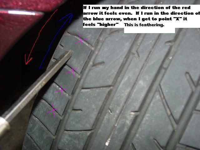

Thats not "tire feathering". That is inside tire wear caused from negative camber. "Tire feathering" is when every other tread block is more worn than the previous one. I will see if I can find the pic again to show it.

Here is one pic where you can see the discoloration of everyother tread block or so on the inside:
Here is another Dr Bonz shot:
You should be able to feel that all the inner tread blocks are not the same and aren't smooth like the outside tread blocks.

Your right I haven't had tire roar, because I don't plan on letting it happen. What I don't like is someone posting a little bit about their problem and someone immediately continuing the "tire feathering" issue even though they have no idea if they really have it. I mean the term "tire feathering" is so over used it doesn't even have a definition any more. If you have any tire problem it MUST be feathering. I hear it is even happening on the back now.

According to the notice i got from nissan, which i still have, Nissan themselves connect the "tire roar" (their term) to "tire feathering" (again, their term). I honestly believe it is a matter of severity; i believe that if i would have continued driving on those tires, they would have begun to show those gross patterns posted earlier. Luckily, i learned about feathering on my350 just weeks before i noticed the noise, so when the roar began, i knew what it was, and even the nissan mechanic, when he drove the car and felt the tires, confirmed my suspicions of feathering, even though no gross signs were present on the tires.
