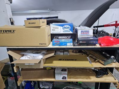

so I put my order in for all the fix it parts. Ive decided to say screw it and do bottom end, wiesco 11:1 pistons and eagle rods from CZP. Im curious regarding the cam. the tomei 266 duration is what Im looking at. I also considered the 274 and JWT c8 which is 272 if I remember right but for $700 more, I think Im going with Tomei. since its for an autocross and I wont be in the revs as much as on a legitimate track. the 266 I believe should be the better option if my understanding is correct about cams. anyone confirm this?

quick photo dumb from the past week. Christmas was a bit busy so didnt get to make the progress I was hoping for but happy how far its come with the limited time I did have to work on it.
having the front end off makes access to the headers slightly less miserable lol. still the worst part of the whole project so far.
I went with 11:1 compression pistons and the 266 degree cams.
dont mind the clamp Im using as a hood prop. its actually holding pretty solid.
