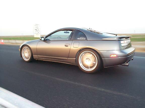

being a twin turbo 300zx owner I was going to jump in on this thread and clear up alot of stuff. However, you folks handled that pretty well. Bottom line is this. The 350z is one beautiful car. I am in love with the silverstone and I will purchase one in time to come. However, if nismo,greddy, hks , or whoever offer forced induction, GO FOR IT! Also, for you folks that are in the bay area and never rode in a TTZ Myself or Kyle would be glad to give you a ride and introduce you to the powers of the boost. If there is another meet at strickly Z and we are there. just ask and I am sure we will oblige you...
