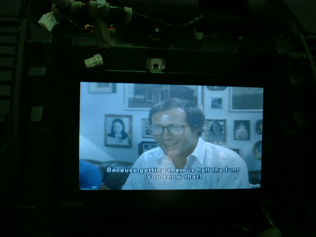

Old Nov 10, 2002 | 09:05 PM
rcamooso's Avatar
rcamooso
Posts: 40
From: nj
check out the subtitle
