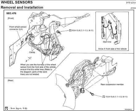

hmm.. where is this rotation sensor located?
Not sure how good this is going to come out....
