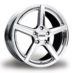

Do u think these look good/would they fit an 05' Touring Z. I have these on my Firebird Formula now. Hmm if you guys dont see the picture here's the link ............ http://www.eaglewheels.com/077.htm The 18". Thanks in advance.

Only way you'll really tell unless someone already has them is to ask for a fitting chart mate.... they not got one on their web site ?

OK first thing - check the bolt pattern - it should be 5 x 114.3 mm looks like they're rounding them up and the 18" offset for the std zed wheels is +30mm all round.
Don't forget revolutions per mile need to be 777 front & 756 rear to keep you from having ESP problems. That can be adapted by your tyre size though.
Best thing to do is find someone local with a zed and try em on

I dont think they will fit..Your looking at a domestic bolt pattern and import bolt pattern. Although I may be wrong.. Let us know..

The Firebird wheels have a 5-4.75 bolt pattern - they won't fit on the Z. Even if they did, they have too much offset (38mm) so they'd tuck in too much.

Get some Privat Fahrens then ... the eagles will likely be the wrong offset and the wheels will look tucked.
