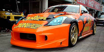

that in the stream car,made another car and it hits 200 no problem now.its in the option vidoe eight i think.with him in his new car.butthats off the topic have u even top'd out the z yet.if so just think of how the car reasonded and X it by 20 or something just because its only 50 mph faster doesnt mean its only coming to be a little bit different,every little thing u hit on the road or every little move u make is going to make the car move all the way across the road.

go buy the 2 option videos that cover the stream z. watch them, learn from their mistakes. also, they were trying for more like 250, 200 wasn't the hard part. i think a 350z with about 10k could get you there. pay attention to the speed rating of your tires, add some reliable hp to get you up to about 380whp or so, change the rearend gearing, focus on cheap aero mods ( you will see some of the fastest cars in the silver state race such as the black camaro seem to use duct tape(?) and fiberglass to move the air where they want it around the car ), and get out to the few places that will safely ( kinda relative at this speed ) let you get up to these speeds. a cage, seat, harness, and good health insurance seem to be a good idea. that, or get a z06 or viper and go for top speed. seems easier that way.
oh, almost forgot, the most important pieces are going to be a bigger radiator and oil cooler, depending on what you do with the airflow around the front end.
