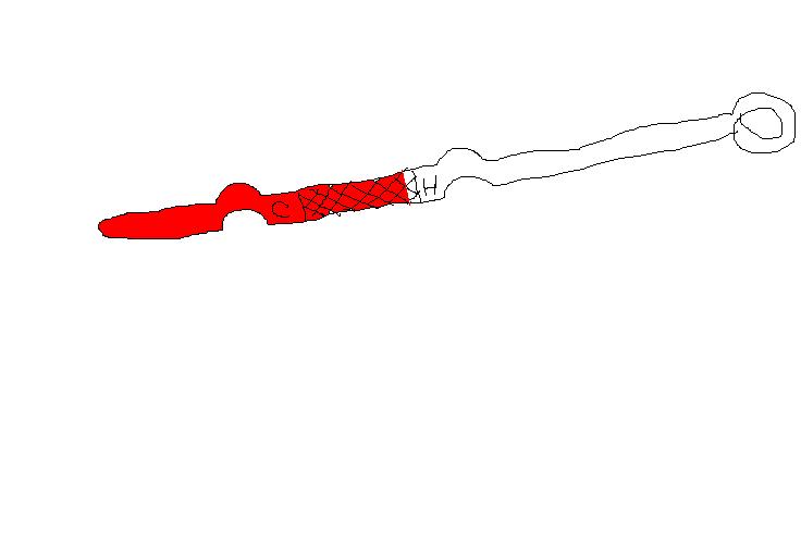

As you can see from this realistic picture, the dipstick has a grid between the curves that indicates how much oil your car has. You want the oil (red) to be as close to the "H" as possible without going over it. If the oil is towards "C" or "L," you are low on oil. If you are near "H," you have enough oil.
By the way, to check the oil, you'd first need to wipe clean the stick, put it back into the engine, then pull it out again to see the level. If you don't know that, then may god have mercy on your soul
Also, I change my oil every 2-2.5k miles, just because I like the smoothness and power of new oil. I don't think it's worth it to run old oil for 4k+ miles just to save 25-30 dollars on oil change. $30 is barely half a tank of gas....
