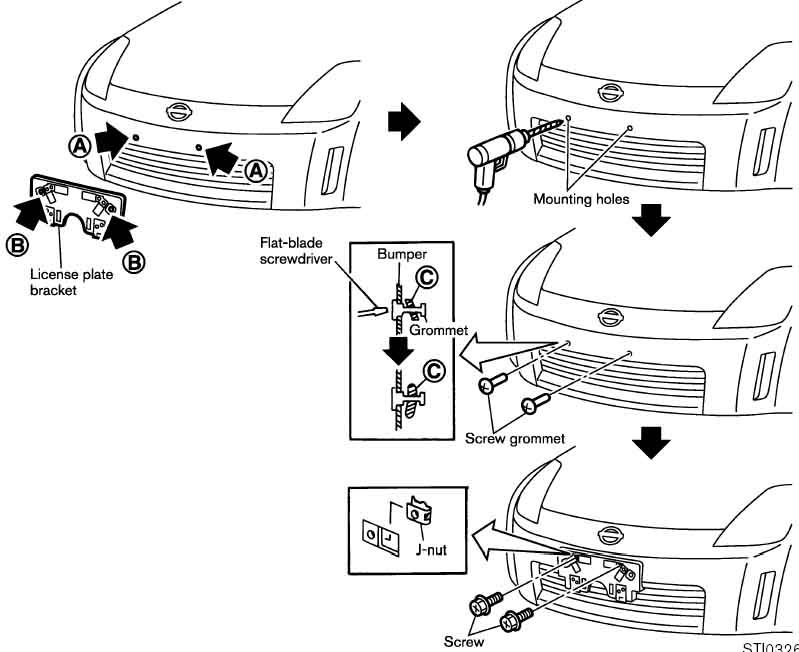

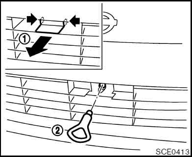

Old Jul 31, 2002 | 12:19 PM
zPilott's Avatar
zPilott
Posts: 532
From: Austin, TX
from the manual:
After removing the front license plate (if so
equipped),
q1 Remove the towing hook cover from the
bumper.
q2 Securely install the towing hook stored with
jocking tools.
So it looks like that piece is on the production model, so it should be pretty easy to make a license plate holder that screws into where the tow hook should go.
Attached Thumbnails Is there a different way to mount the front license plate?-untitled-3.jpg
Old Jul 31, 2002 | 12:49 PM
zPilott's Avatar
zPilott
Posts: 532
From: Austin, TX
Man, this is a scary picture, I would be very angry with anyone taking a drill to my car:
