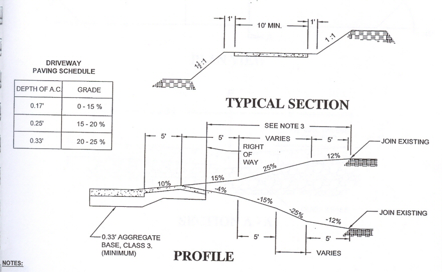

We had to redesign several driveways for some house up in Desert Hot springs, the driveways looked like that picture above, they had to tear the concrete and put grade breaks in order to make it work. San Diego County has a standard detail for it.. The slope of the sidewalk has to be 2% slope max (sloping towards the street) you can not touch this because of ADA standards (handicap standards). When I get to work tomorrow ill scan the detail and post it..
My family runs a Civil Engineering Bussiness so if you can provide topography and distance from the sidewalk to your garage I can design the driveway for you no charge...

Sorry, I haven't gotten back to this thread in a few days. Damn work! I appreciate all (ok, some ) of the feedback!
Since escrow can't close until this is resolved, the seller has become highly motivated
They've just engaged an engineer who supposedly does this sort of thing all the time. They're going to rip out the driveway tomorrow and redo it early next week.

This is what they will have to do...
Attached Thumbnails can't make it down my new driveway :(-scan.jpg

GREAT !!!!!! Lots of severe grades are a product of a poor initial, or I should say focked up initial survey and grade layout. As the property goes through its completion, it becomes worse and worse----An accumlative error, by then, It is too late.
Just a couple 10ths can turn into 2 feet.
