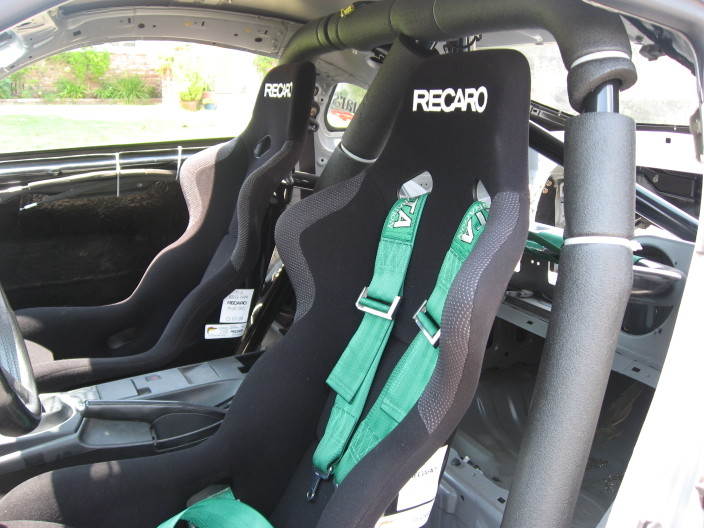

Making the Z lighter???-img_0089.jpg here's skeleton weight
