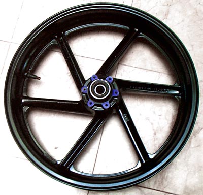

I dunno about the handles either, but i recently spray painted my motorcycle rims. They were the ugly purple CBR rims and I spraypainted them black using engine paint (resistant up to 500 degress Far supposedly) then used 2 cans of engine clear coat for each rim. I think if youre gonna paint anything black, its not necessary to spend money and powdercoat them. I spent a total of $20 for mine and you can't tell the difference. People ask me how much i spent powdercoating them and are amazed when they find out i spraypainted them. The only thing im not sure of is the long term strength, but im pretty sure itll be fine.

They're actually a lot glossier than they look in the picture.
And if you are thinking of trying this, make sure you sandpaper the hell outta the rim first.

I personally wouldnt spray paint, it wont hold up... itll flake, and I think on a larger surface, inperfections in the coating will show up very clearly.
