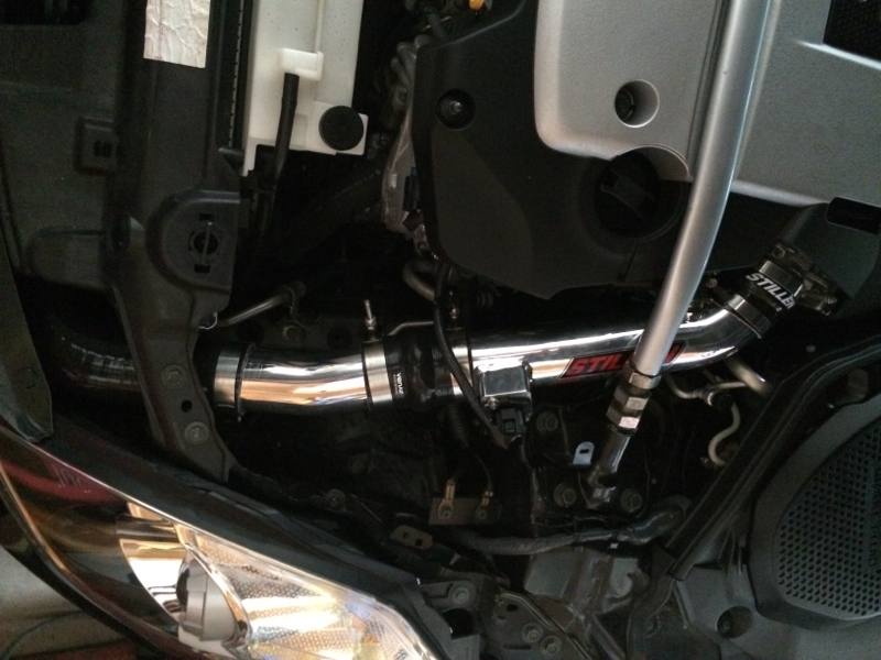

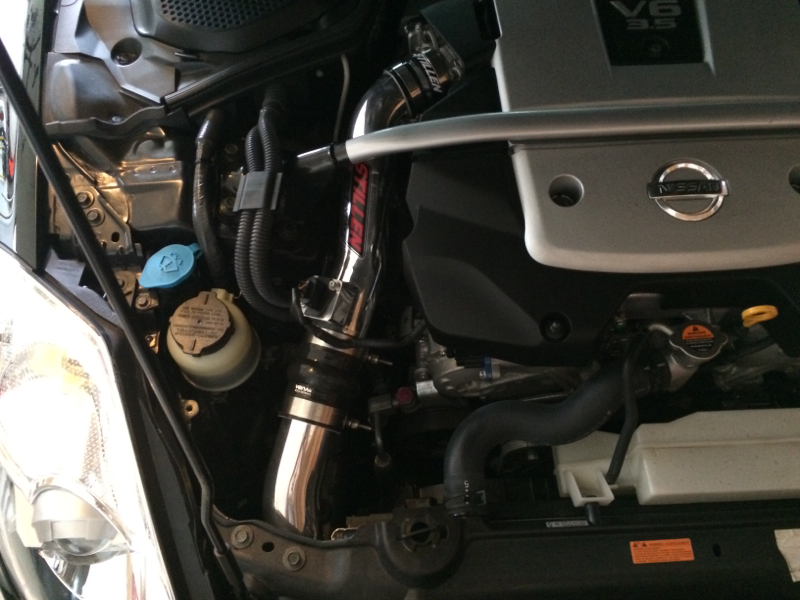

Modified my Stillen Gen 3 intakes for a better fit inside the bumper today. I didn't like how tight everything fit together so I added silicone elbows like the Injen version and also hump connectors to relieve stress on the pipes and filters.
