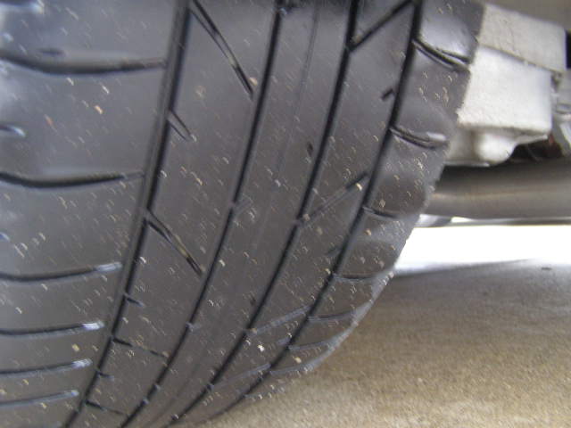

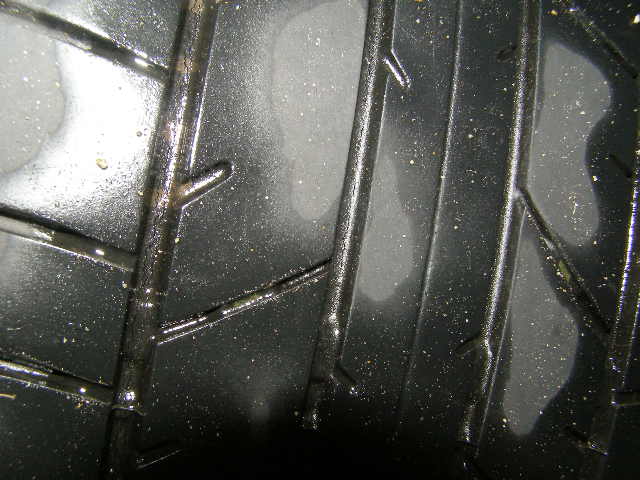

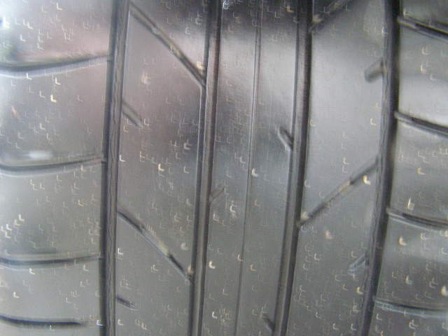

I think maybe I was going about 26mph when turning then gave it more gas more than I should of to cause this. I'm just glad I didn't hurt anyone or the car it was a nice save. I have a tire tread depth gauge i'll find out what it reads first thing tomarrow. I know my tires are not at the wear bar yet. This is going to take weeks for this to get out of my head I feel like ****. I'll change my avatar asap.
The tread depth doesn't look like it should have been the problem. You answered a lot of the questions I had so it sounds like you were just going to fast. The Z, like many rear wheel drive sports cars, handle great but they can get away from you if you overstep the limits.
Tread is thin but worn evenly. Very unusual.
