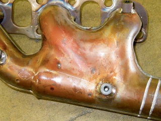

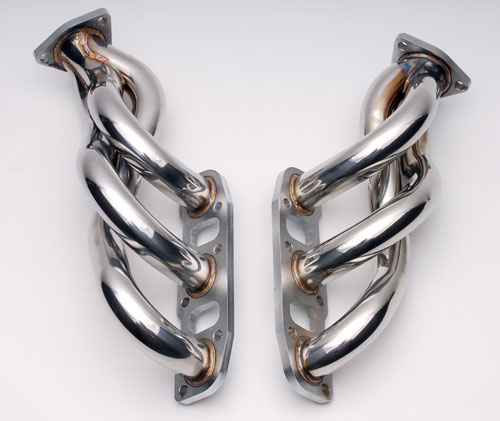

Stock are exhaust manifolds, not headers. The difference is that a manifold doesn't have pipes of equal length like a header and are usually cast or forged instead of using mandrel bent piping of equal length easy to tell difference as you wont see a crazy pipe design so that the front cylinders equal the same length as the back, Also Nissan is a ISO9000:1 company so a header system would be outside of the poke-yoke (variable proof system) due to the fact that it requires too many components and constraints..

heres the difference
stock is cast rust real easy aftermarket is stainless
