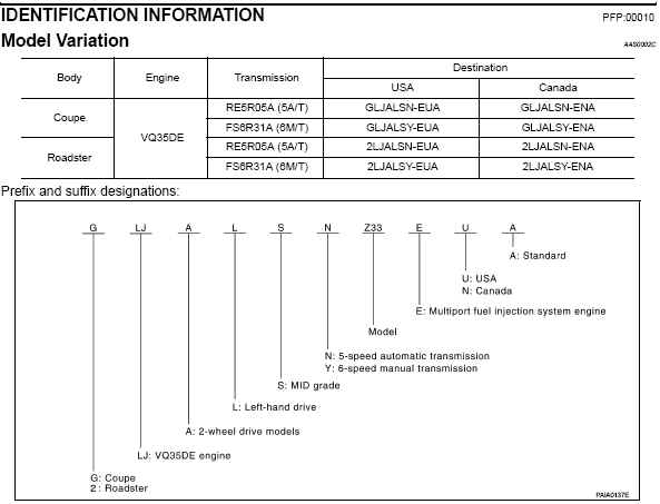

Are you talking about the sticker that has a string of codes that look like these?
Attached Thumbnails Trim: G, but my car is a base!?!?-snap.jpg

Old Oct 31, 2009 | 09:25 AM
aaronz8's Avatar
aaronz8
Joined: Aug 2009
Posts: 254
From: Irvine, CA
The sticker's more like
VIN#
Color: Trim: something: something:
code G forgot forgot
It's the sticker in the door jamb.
