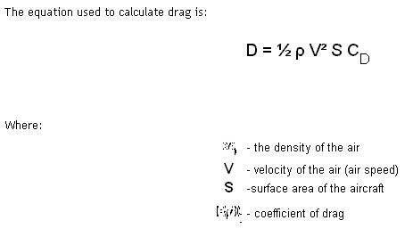

Originally posted by 350zroadster
Nope, A is the surface area in contact with air. Cross-sectional is accounted for in the drag coef.

i was using a simplified drag equation like the ones presented here:
http://www.ac.wwu.edu/~vawter/Physic...DragForce.html
it probably wouldn't do for fluid mechanics, but it's definitely good enough for my purposes here (especially considering i don't have anything close to the relevant numbers for surface area). no need to go overboard.

Originally posted by archman350z
Actually, RANDS is correct. The formula he used does not take into account the surface drag. That is a whole different (and very complex) formula. Unless the object is unusually long or wide, surface drag is pretty negligable compared to the effective frontal area.

350ZROADSTER, I think you're right...I'll have to look up on this. I know that it makes a big difference on whether the flow is laminar or not (which has to do with the shape of the object and the linear speed of the flow)...hmmm maybe it was the equation for Cd that was the real ******#$&!...
