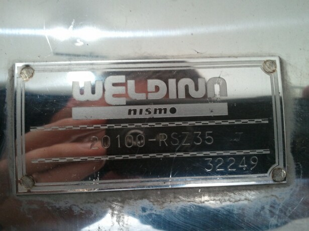

How do I find out which it is, He send a pic of the muffler and serial number and everything on the muffler.

Old Mar 8, 2011 | 07:46 PM

Pic attached.

I think thats the s tune one, do you have a full pic of the muffler? but im sure its the s tune. Also find out if he is including the mid pipe with it

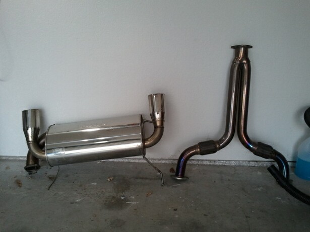

I think it is too, He is only selling the muffler and y pipe,
here is the pic of both

yeah thats the s tune your going to need the mid pipe to bolt it up, or go custom at a muffler shop

He says it will bolt up to stock midpipe.

no it doesn't, thats a 3in flange on the s tune muffler stock midpipe is 2.5 and it also shorter

^ This! It's not hard to have a decent muffler shop do it, but it will sound same as stock without the Nismo mid-pipe

Wrong. Not only do the pipe diameters not match (not the biggest of your problems or even a problem for many actually), they won't even mate (pipe routing is slightly different) and you would need bolts/nuts/washers.
Just take it to a local muffler shop and they should be able to fabricate you a mid-pipe for real cheap. Just make sure they use a nice metal piping with good mandrel bends, resonator is optional.
