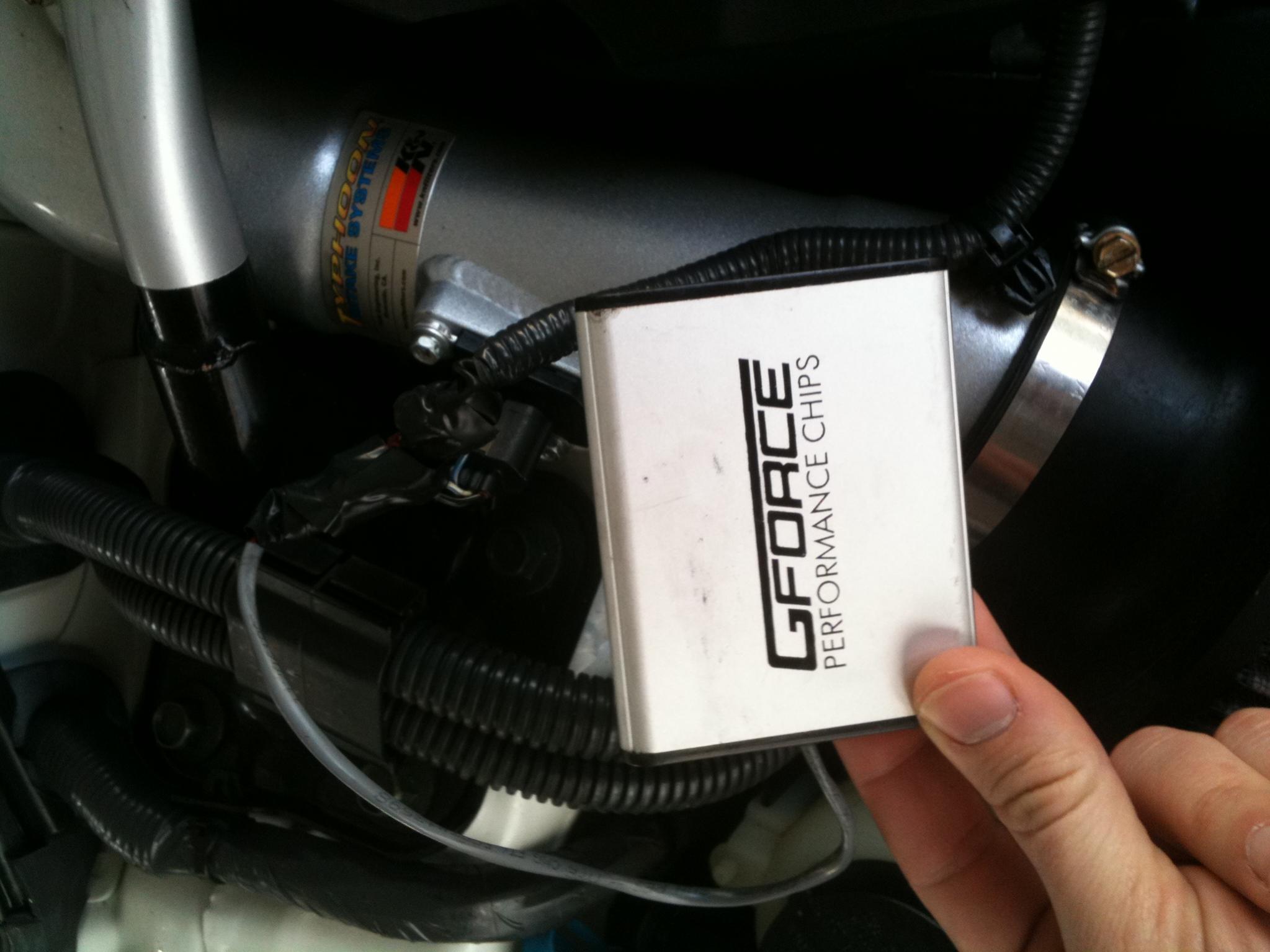

Ok, this maybe a dumb question, but im gonna ask it any way!
just bought 08Z on friday, been noticing a rattle under hood during braking or over speedbumps. upon investigation i find this little gray box hanging by wires from pass. side MAFs on my K&N dual air intake, wired in with clips. It says nothing but "GForce" performance chips. further google search reveals ....wait for it...60HP gains and 4-7mpg better!!!! for only 69$ So my questions is..."is this a DumbAss chip? if not, (pretty sure it is 60hp for69$ is far fetched) ...should it be hanging from/ wired into my MAF port?
My instant idea is to remove it and go for a drive!
Other question is: Could this have anything to do with my code for coolant temp too low/ temp stuck on open loop it seems?

Remove it immediately!

heres a look at it

its a gimmick. remove that **** off immediately and burn it with a propane torch.

350z's don't use chips. Yank that sucker and go punch the previous owner for being a douche LOL. Not a dumb question since you're smart enough it seems not to fall for that crap.

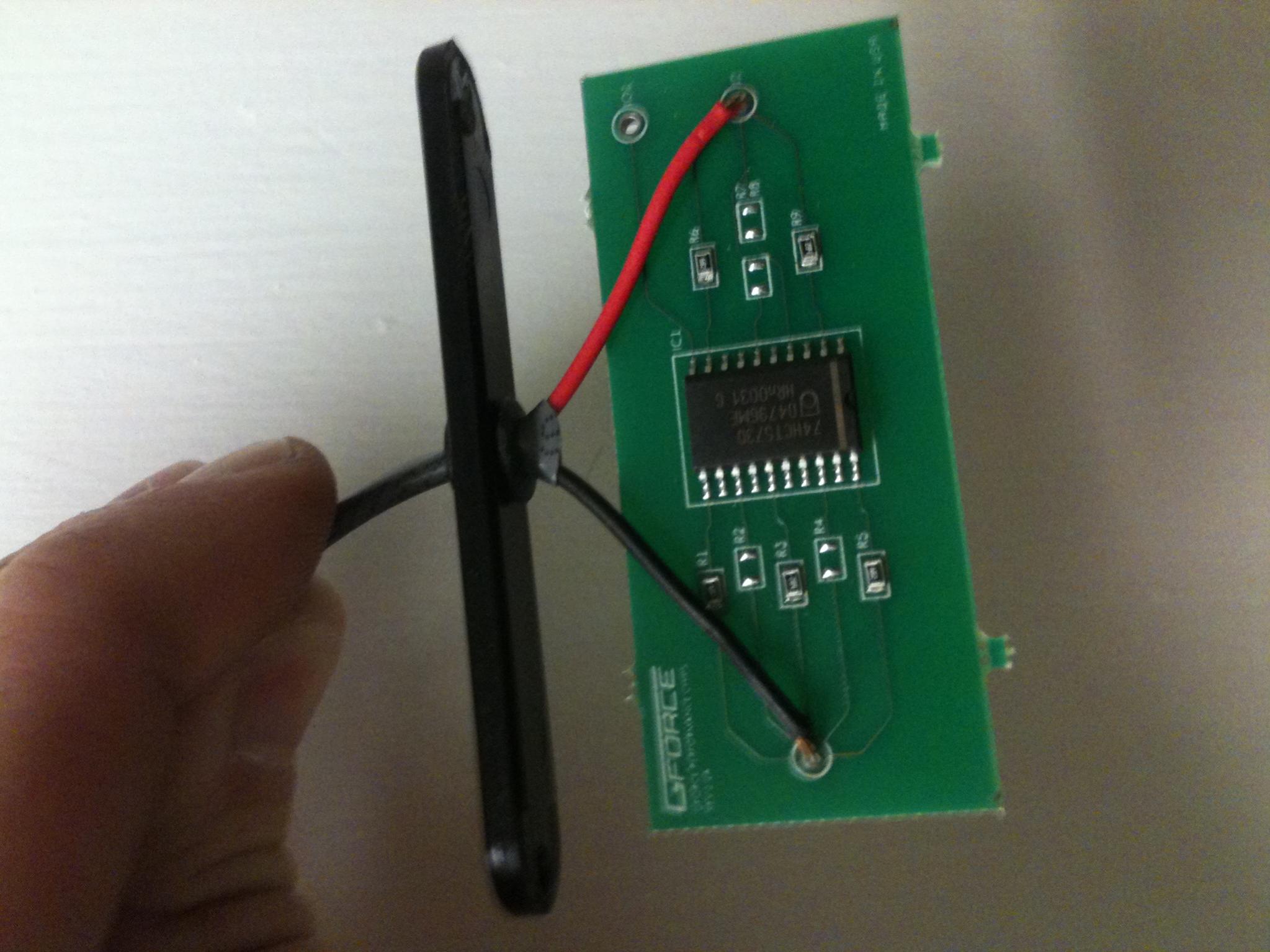

So....two snips and a spin around the block reveals.......nothing....car runs exactly as it did prior, i didnt lose 60 hp, crazy i know....one thing that did change however is i no longer have an annoying little rattle in my engine bay
I took it apart to see how high tec this thing is...wow...60hp pic included
GFarce!!
GFarce!!
LMAO great first couple posts brother :thumb up: Sorry about your 60HP loss.

Any chance we could trouble you for close ups of the circuit board?

Its a simple resistor that does absolutely nothing. Might want to check in the bay for an electric supercharger or a turbo fan.
