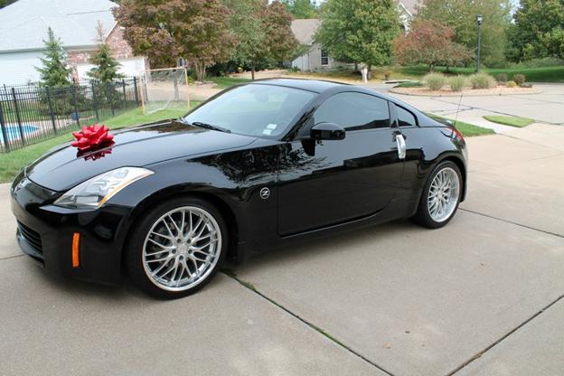

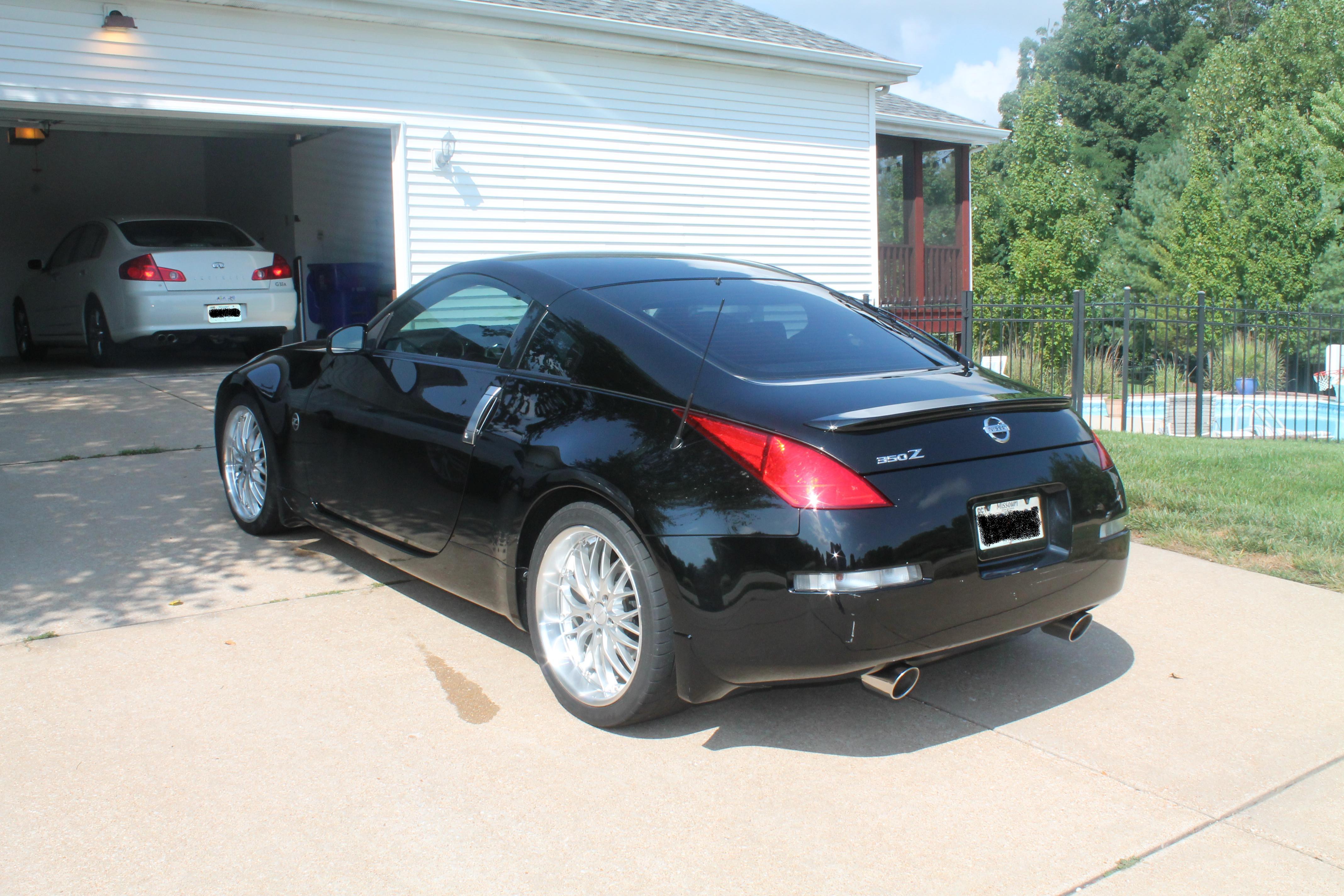

Hey guys, I have been on the forum for a while, but am just starting to post so I can introduce myself and my car and tell you guys what kind of plans I have for her. First of all, I am 17 and I have had my Z for almost a year now. I know there are a lot of people who believe people my age shouldn’t have such a great car. I agree with you. I am very lucky and I wanted to make sure you guys don’t get the wrong impression. I am responsible, I have good grades, and I have also been racing karts around the country since I was seven years old. My dad taught me how to polish and wax when I was younger than ten on his own RX7. I wash my car almost once a week if I have the time and never run her hard. I do however love to spend money on my Z!
This is my 2004 350Z Touring.
Attachment 356535
As she sits:
Sketchy AEM Intake from previous owner (no bracket to hold it stable, putting one in this week)
19” Hyper Silver MRR GT1 Wheels w/ Nitto INVO tires: 275x35 and 245x35
Pioneer GPS/Radio
Future Plans:
My Motordyne Shockwave TDX2 Exhaust is being installed this Monday. I also bought the MREV2 and the 5/16” Copper Iso Thermal Plenum Spacer. I am having the exhaust put in professionally by a local guy who has been a friend of my dad’s for a long time. I am putting the MREV2 and the plenum spacer in myself. My original plans were to get the ART pipes and HFC midsections, but they wouldn’t pass emissions so I couldn’t go with that setup. This setup will be amazing none the less.
Future Plans:
1. Motordyne Adjustable Swaybars
2. KW V2 Coilovers
After I get these things done, I want to change the look of the car a little as well. I was originally thinking of switching out the whole front bumper and getting a carbon fiber Nismo V2, but figured I would save my money and just get a lip (Leaning towards MINES). Next, I want to get the nismo side skirts, voltex rear diffuser, and blitz spoiler.
Tell me what you think! All comments are appreciated, feel free to critique my plans and tell me your ideas/opinions. I will be posting videos on my youtube channel when the exhaust is installed and I will embed them in here also.

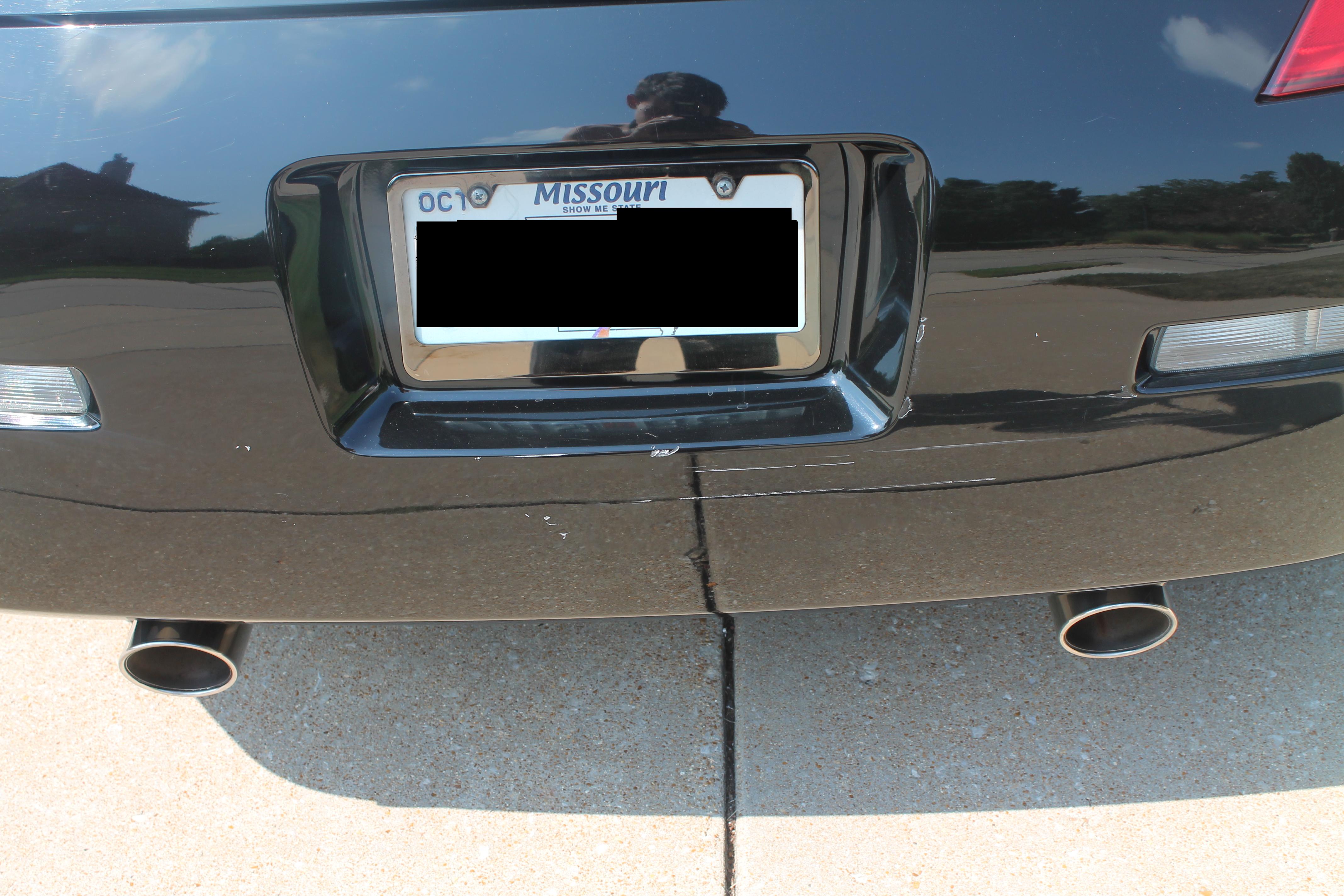

This is some of the damage that came with it when I bought it. The guy said it was from valet.

I think its looks pretty standard
personal preference: I don't really like the design of those rims, some others do but I never liked those too many spokes....
a lot of the small mods are not even worth the money if you were to calculate the money spent divided by the hp gains. You will hardly feel a difference... If anything wait to buy a turbo or supercharger at a discounted rate on the forums.
appearance mods sound like a good idea, personalize and customize I can pretty much guarantee that you will get more compliments on a day to day basis. I had about 5 grand and had a choice for turbo or appearance mods, I chose to alter the appearance of the car. Never looked back
Thanks for the comments. Im changing the wheels asap. Im about $600 away from work emotion kiwamis. So about a month and a half from now

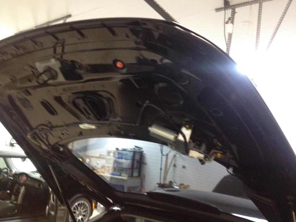

Hey guys, haven't given any updates in a while, but about a month ago I did a rear wiper delete and it turned out great! Right now I have a plastic plug in that is matte black. Do you guys think I should even bother painting a metal plug gloss black? To be honest you can't really tell unless you are looking for it and I feel like the metal plug will bulge from the body more. It fits very tight and definitely isn't getting any water leaks. I had to file around the sides of the whole to make the plug fit, but it was very very little. Only other problem I had was getting the interior off. I actually broke a wooden spatula i was using to try and pry it off because it was so tight! Here are some pics: Probably about a month or so away from getting wheels and two from getting them installed!

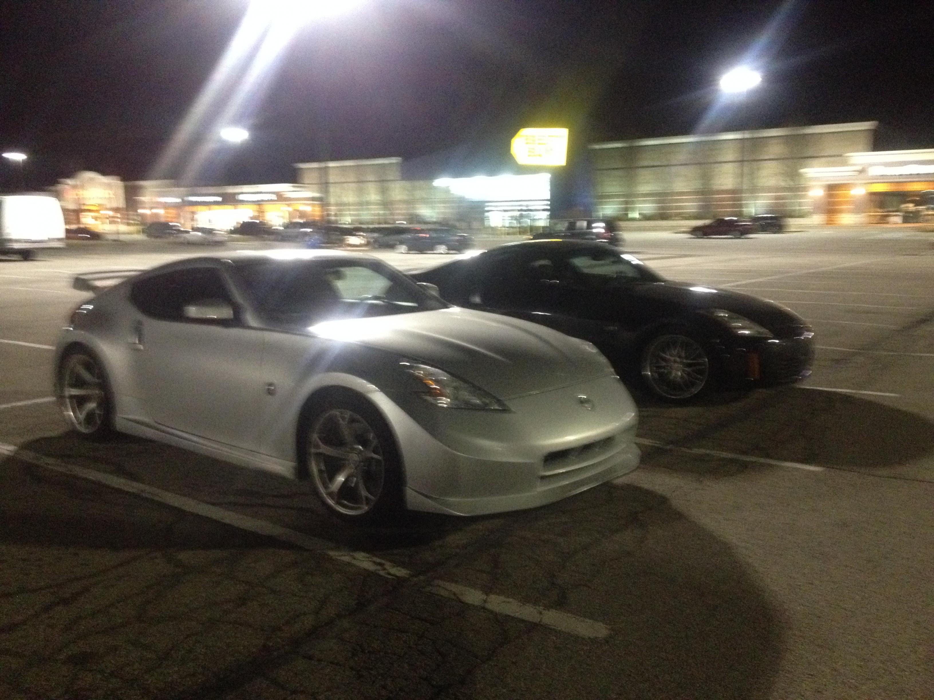

Attatched are some pics of my friends new Nismo

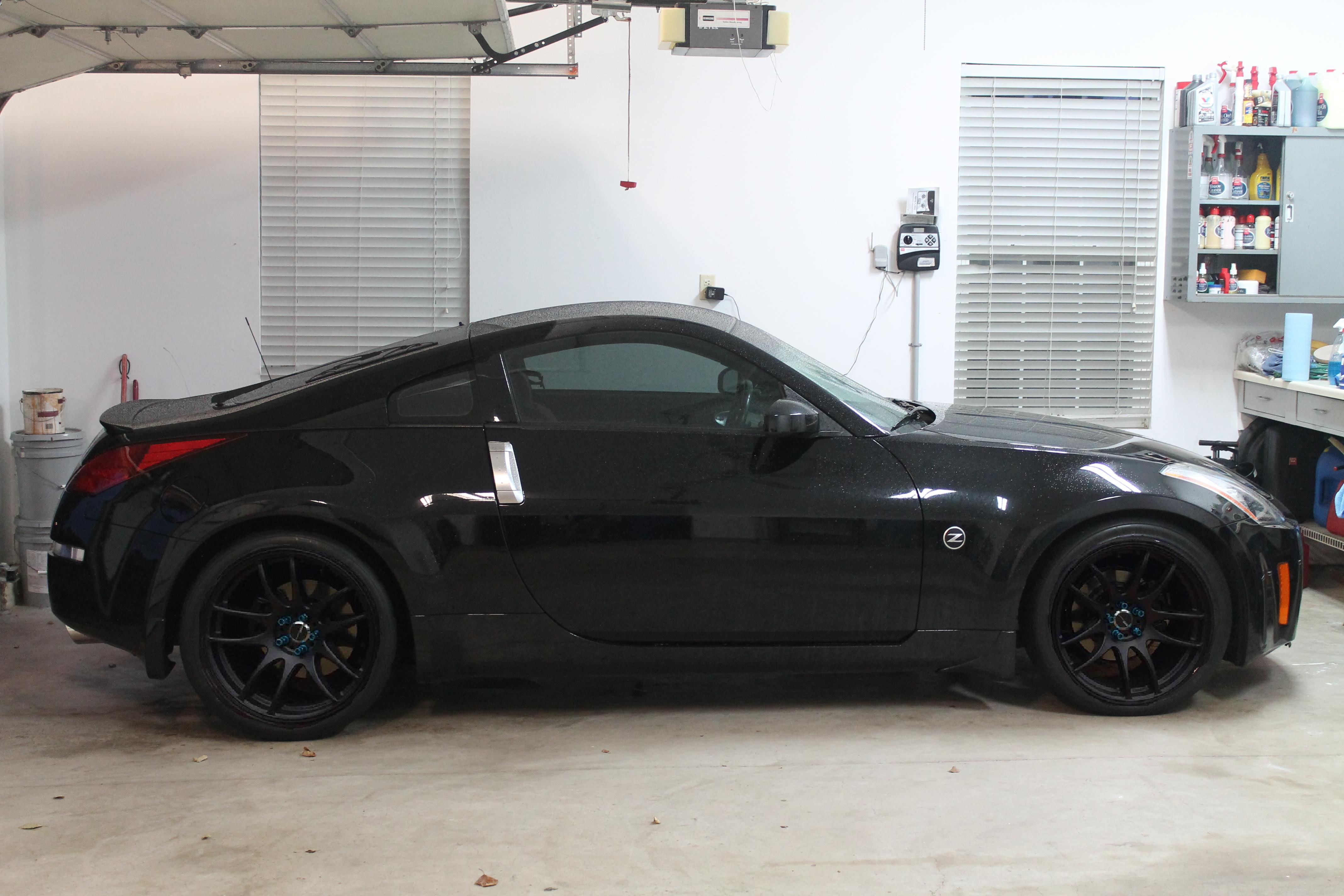

I've been playin around attempting to photoshop some new wheels on "paint" lol...this is what I came up with (See attatched). What do you guys think? I'm beginning to lean towards black now for a couple reasons. First, it is $100 cheaper...not a big deal but is still a pro. Also, it makes it look more mean in my opinion vs silver and it also never looks dirty. I've never been big on blacking out cars, but I love the look of this.
Yea i am planning on it, i tried doing that on computer but was too difficult, that is definitely on the list
