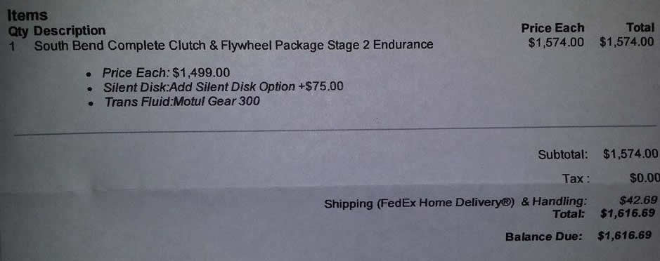

Thanks for the replies. I'm the type of guy that would rather do it right the first time if I'm gonna be in there. Lord knows I don't wanna have to go back in the bell 20k miles down the road.
I went ahead and ordered the South Bend Clutch Stage 2 Endurance kit from ZSpeed Performance which includes:
-South Bend DXD Clutch Stage 2 Endurance Clutch Kit
-South Bend DXD Clutch 19lb Billet Steel Flywheel
-ZSpeed Heavy Duty Concentric Slave CSC Kit with Stainless Fluid Lines
-ZSpeed Wilwood HD Clutch Master Cylinder Kit
-Motul Gear 300 Trans Fluid 4 liters
-1 Motul 5.1 Clutch/Brake Fluid
-Pilot Bushing
-Clutch Alignment Tool
I gotta grab a rear main seal from Nissan.
Can anyone think of anything else I/the mechanic will need during the install? Like I said. I want this to be once, and done.
OUCH......

you should be done, i was looking at the southbend setup before i sold the car. glad you got the z speed slave, you will never need another one

You did good buying something good from the beginning and dropping the bank at one time. Instead of buying cheap parts then something happens, and you end up spending more money. You'll be set for a long time with that setup for sure.
