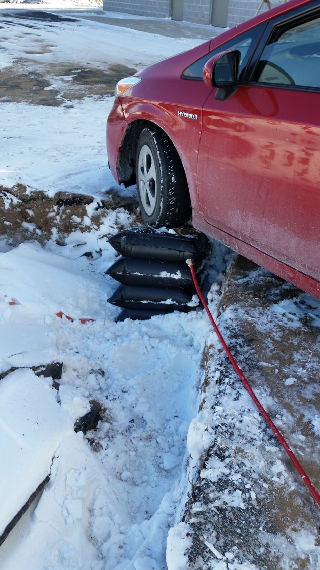

Picture of air jack in action.
Disclaimer this is not the proper way to use this air jack I just thought it was the easiest way to get this car out of a big *** open hole in a construction zone that someone decided to drive into.
