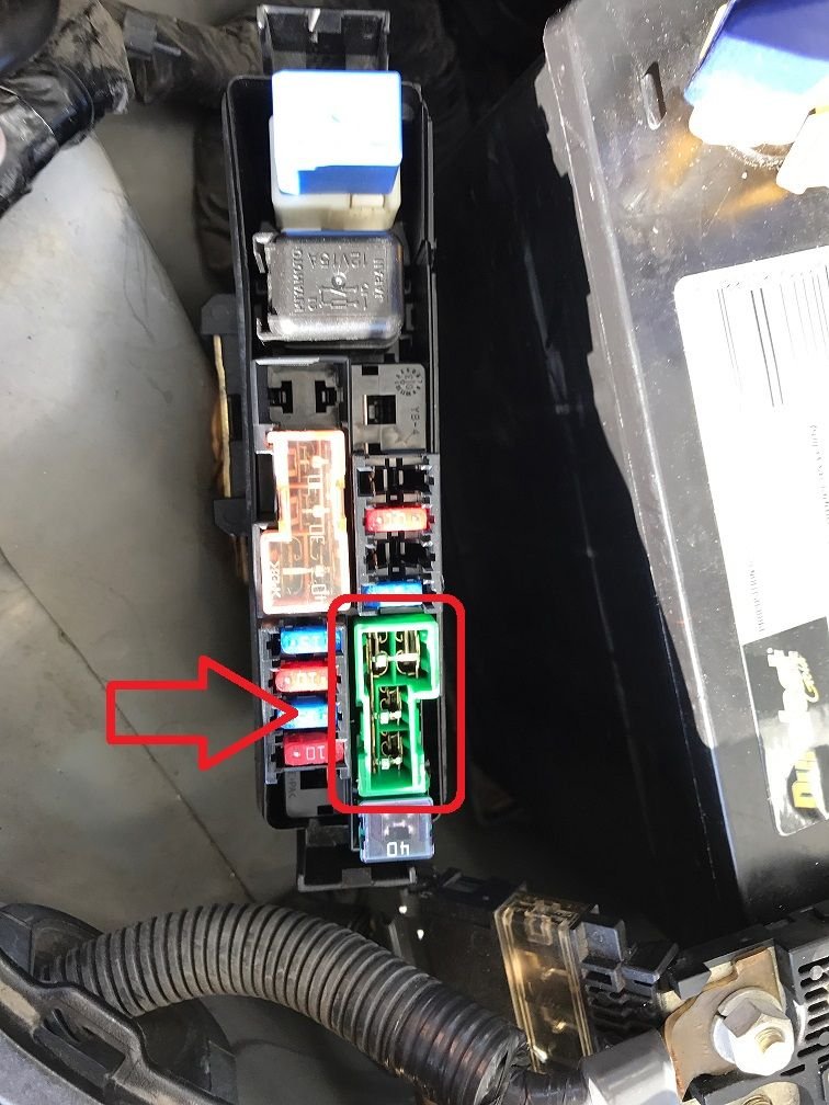

I wanted to reply again to confirm that I need to be looking at the white box that sits behind the HVAC switches in the center console. I only ask because Master Google is telling me the BCM is a box that sits next to the fuse panel in the driver side footwell. I'm a little confused now on where I need to go next.
Old Oct 26, 2016 | 08:20 PM
cmarens's Avatar
cmarens
Joined: Oct 2016
Posts: 6
From: Sioux Falls South Dakota
Sorry, Master Google scores again. That white box is the unified meter A/C Amp. BCM IS located under the fuse block by your foot.
I was told one day after I had started my car with that ribbon cable unhooked and set off my check engine light that was the BCM.
Anyway, an inspection of the ribbon cable would not be unreasonable as they are very easy to damage and as I learned, it has more impact than being able to turn on the A/C.
Right under the gauges on the center console up top is the fuel door relay. I dont know if that is controlled by the BCM or not. If it is, that would certainly make a clicking noise and could be shorted inside as I described with the defrost switch. With the exception that it would most likely be caused by insulating varnish coming off the coil on the inside.

Old Oct 26, 2016 | 08:30 PM
cmarens's Avatar
cmarens
Joined: Oct 2016
Posts: 6
I hope that picture helps map out the mysteries under the dash.

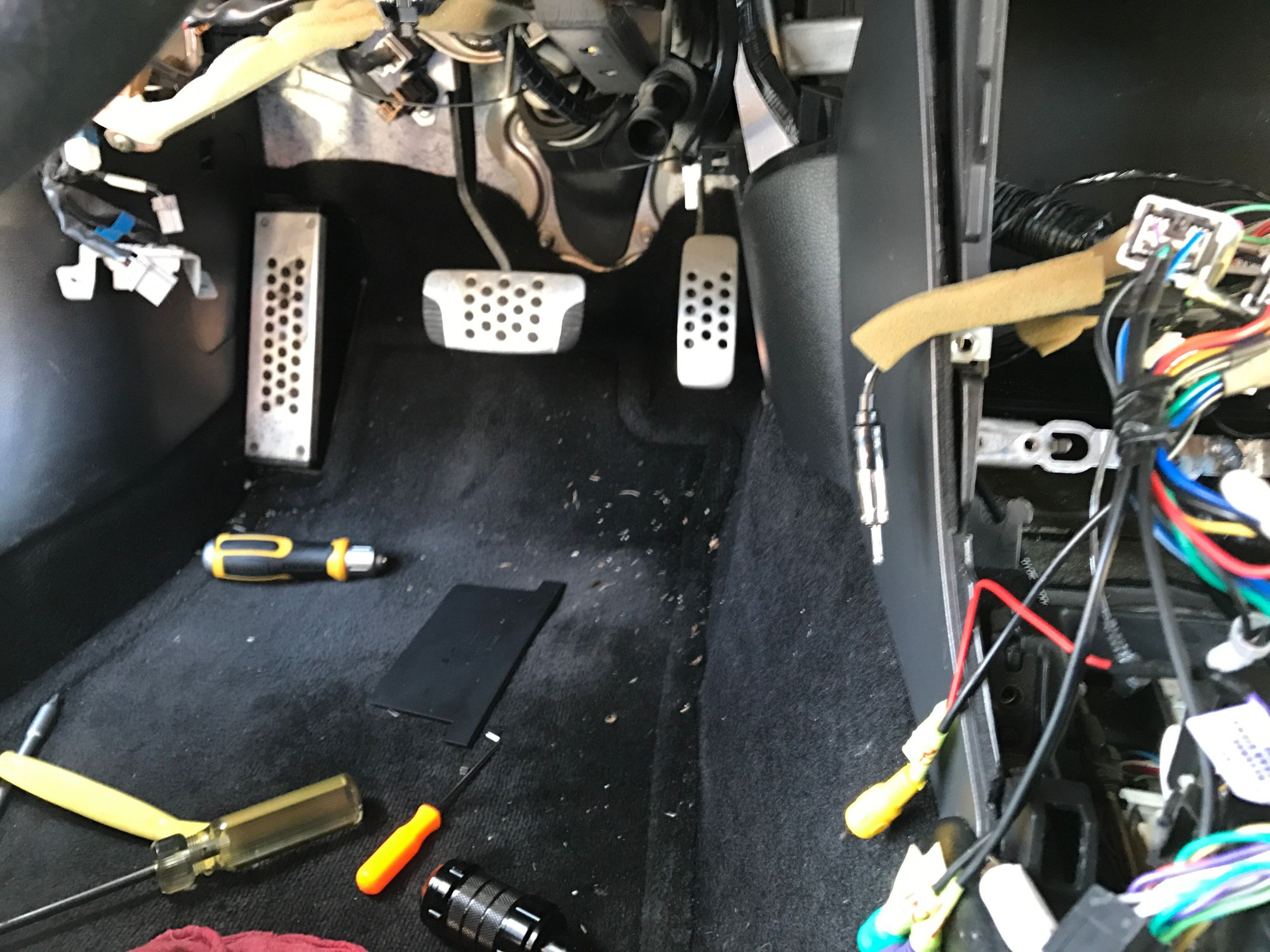

Status Update: I have completely ripped the interior out of my car almost all the way down to a bare dashboard.
Clicking still present?....Check
6 amp battery draw still present?....Check
Remove the driver seat so I can get better access to the underside of the remaining dash.
Clicking present?.....Nope!
6 amp battery draw present?.....Nope!
Hurray, somehow I discovered the driver seat was the cause of my problems after spending hours pulling the dash apart.
Reinstall driver seat to confirm the problem.
Clicking returns?.....Nope!
6 amp battery draw returns?.....Nope!
FML!!
What should I do? Put everything back together? Give it a few hours to see if the problems come back?
