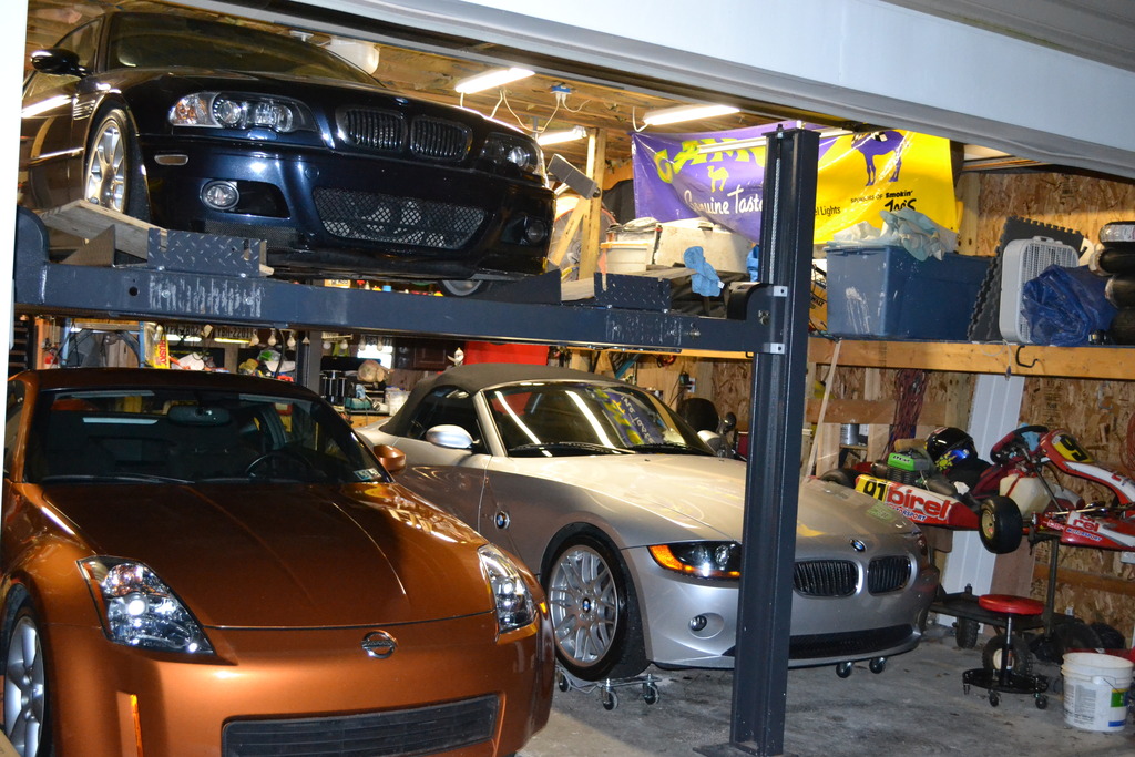

I fill the tanks up, put some Stabil in and hook them up on tenders. Its is better to let them sit then to start them without running them to full operating temp. I have done mine this way for over a decade never a prob come spring.

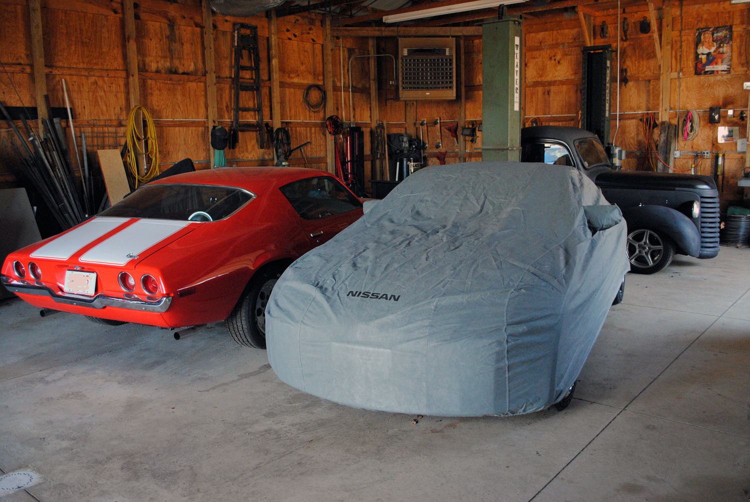

Wash & wax, plug exhaust pipes, disconnect battery, battery tender once month, stay-bil & Sea Foam in tank, dryer sheets inside, small cup of moth ***** on each wheel (keeps mice out) cover.
