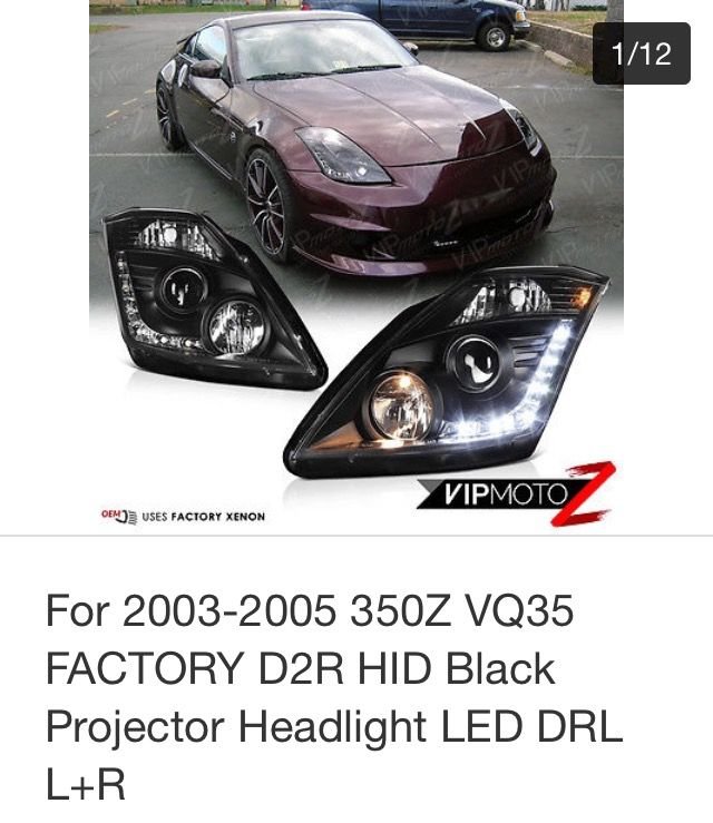

Why didn't I see this before...the vin specs say that I have Xenon high intensity discharge headlights. Huh. Now the seller says I need these instead.
