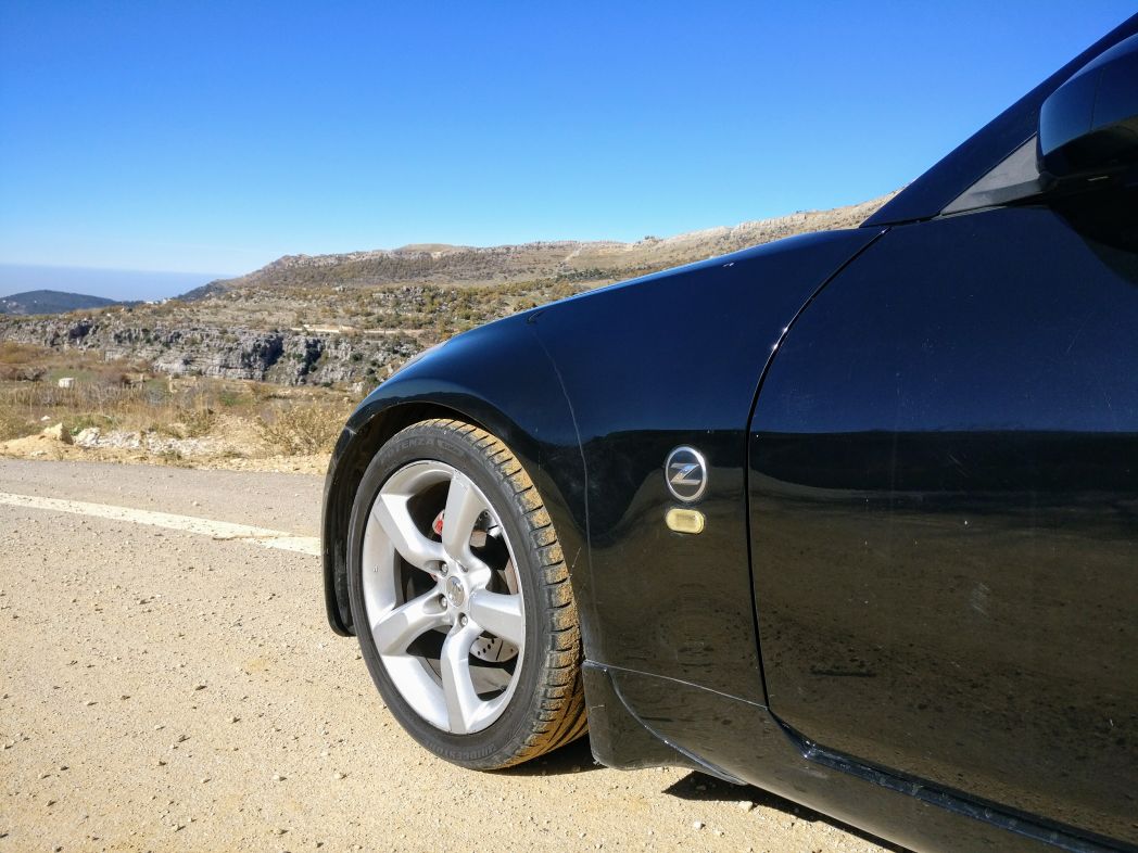

Went out for an early Sunday cruise with the missus, wanted to push the car on the stock shocks and springs before I installed the new ones. Managed to snap a couple of nice photos.
Just dropped the car off for the suspension install. Bushings aren't here yet so I'm just installing the B12 kit. Ran into a pleasant surprise on my cruise. Bunch of really nice classic cars!
For those wondering, those are the Sannine mountains. Altitude about ~1700 meters where I parked. Car felt like it had 200 horsepower up there. :P
Also, as soon as I send the car out for bodywork after winter I want to delete the mudguards, those indicators under my "Z" logo on the fenders, and do an antenna delete. Want to make this thing look a bit better. One step at a time. Sigh.

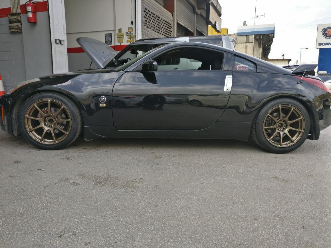

Hey guys. Installed my B12 Pro Kit yesterday. Here's how she sits now. There's apparently an adjustment in the front to bring it up another 1 cm or so to flatten the stance, and I think when I install all the Whiteline bushings I'll do that.
So far I'm very very happy with how she feels. So far these are the best investment I've made into the car. Didn't get as low as I thought, probably due to the fact that my shocks were quite tired already. Which is a good thing, as any lower than this and it would be near un-drivable on our roads!
Sorry for the shitty picture, I usually try a bit harder but it was 7am and it had been raining all night, so yeah.

Took some better photos. So, here's Liza's current stance. I'm going to try to drop the rear another cm, probably by modifying or removing the spring perch isolators or something.
Otherwise, VERY happy with the handling and ride quality.
