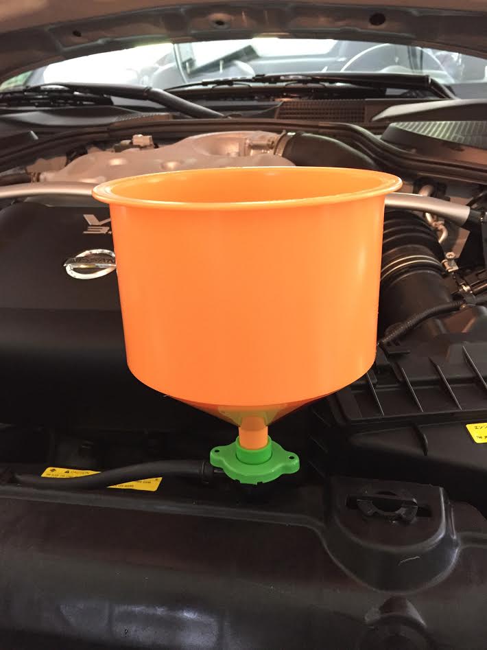

Now for the air bubble issue I bought a spill free funnel and ran the car for about 45 minutes with some antifreeze in it and watched the bubbles come out. Tonight we took a long cruise and had no over heating issues, I think I might be out of the woods, time will tell.

Old Jul 16, 2018 | 01:13 PM
dkmura's Avatar
dkmura
General & DIY Moderator
iTrader: (64)
Posts: 8,624
Likes: 1,393
From: Aurora, Colorado
The Lisle spill free funnel you pictured should burp the system well. Did you notice all the bubbles that came out as you ran the car during those 45 minutes? It also allows quick refilling with fresh mixture and is a must tool IMO.
Old Jul 16, 2018 | 02:02 PM
tmdz's Avatar
tmdz
Joined: Sep 2017
Posts: 222
Likes: 40
From: WA State
As dkmura said.
Also, you need to shut off the engine and leave the funnel (about 1/3 full) in place for for about an hour after you run in. While the engine is cooling it will continue to burp out the air bubbles and replace that air with coolant.
Sounds like you have a case of vapor-lock. Until you get that thing bled completely you will likely continue to have problems with it.
