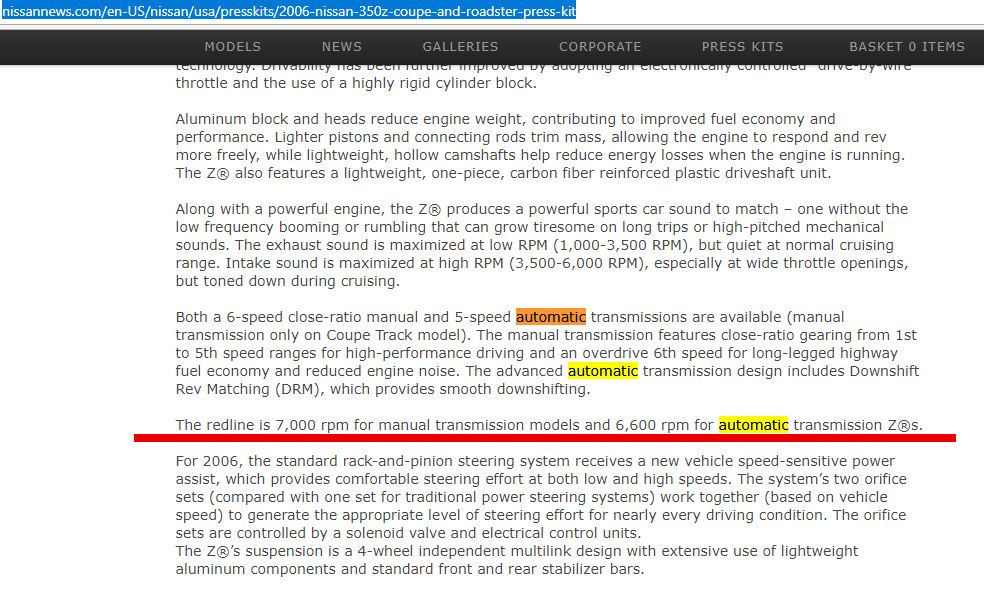

The auto trans has never been paired with the Rev up.
then why does my redline go to 7k?
Old Aug 29, 2018 | 04:29 PM
Jsully24's Avatar
Jsully24
Joined: Aug 2018
Posts: 9
From: California
Originally Posted by icer5160
What Zkiwi said. Terrasmak is correct though, I don't believe 06 autos ever had the Revup engine as the "oil consumption" issue was never connected with the automatic trans equipped 06 350Z.
-Icer
my redline is at 7k tho?
Old Aug 29, 2018 | 06:00 PM
mr. sparco's Avatar
mr. sparco
Posts: 7,090
Likes: 460
From: Sunny Beaches
OFFICIAL NISSAN PRESS: http://nissannews.com/en-US/nissan/u...ster-press-kit
You purchased your car used. Previous owners DO mod their cars, swap parts, reflash the ecu, etc etc. All you had to do was google, 06 autos came with the de non rev-up motor and lower redline from the factory.
